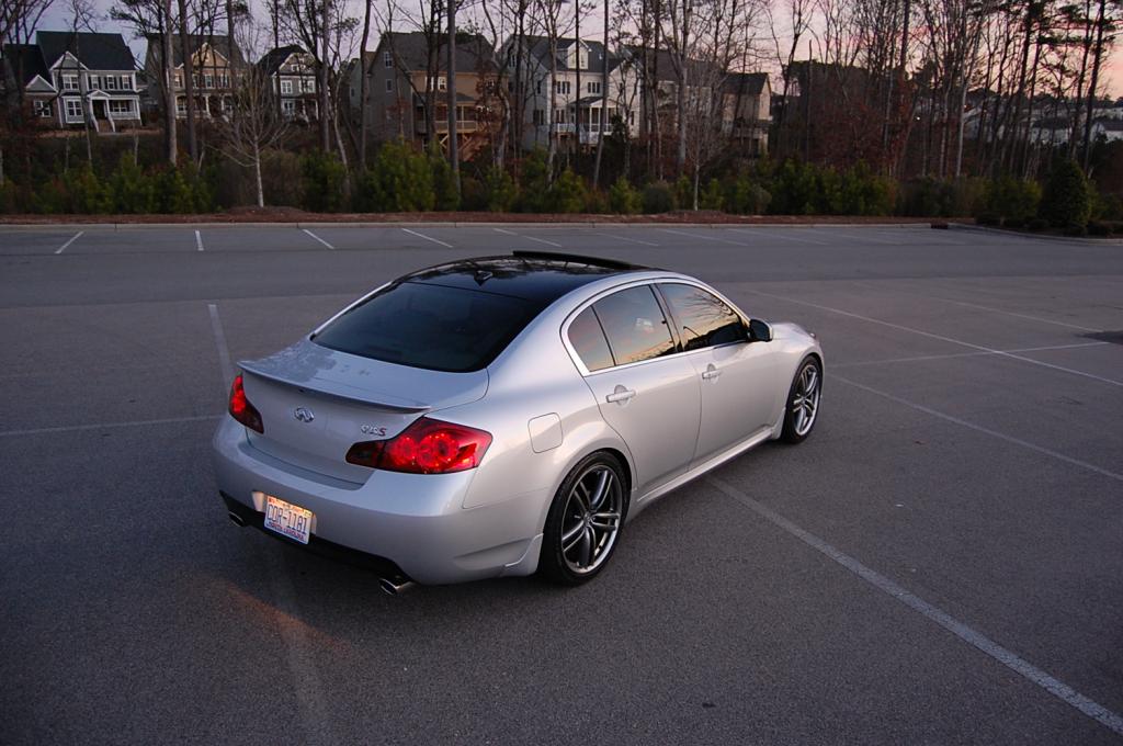

Black is always the toughest to keep right especially since its been neglected. Mine is silver and under the right light probably had the same amount of swirls and light clearcoat scratches as yours...just not as noticeable
