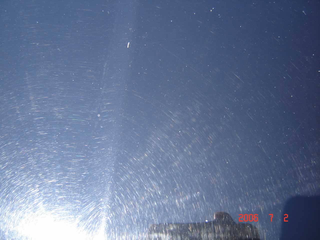

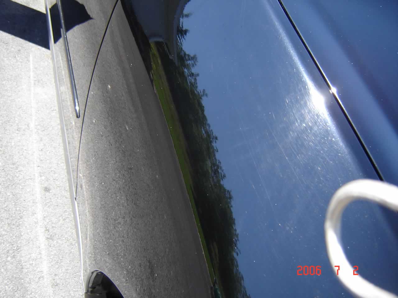

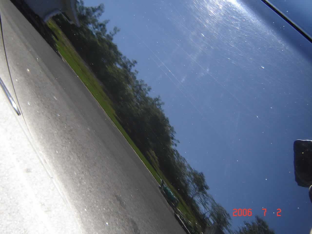

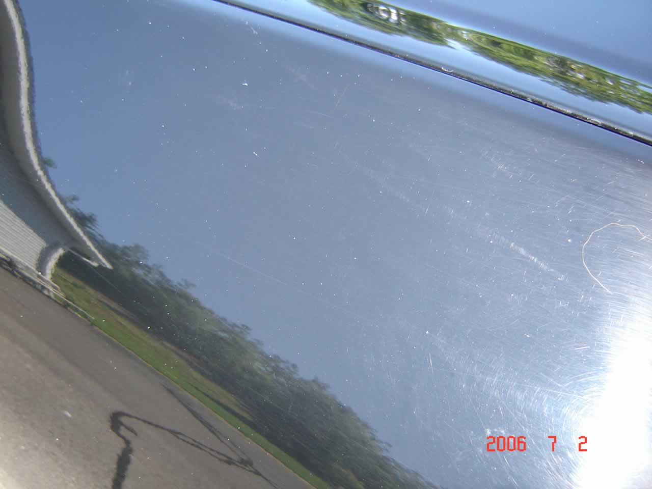

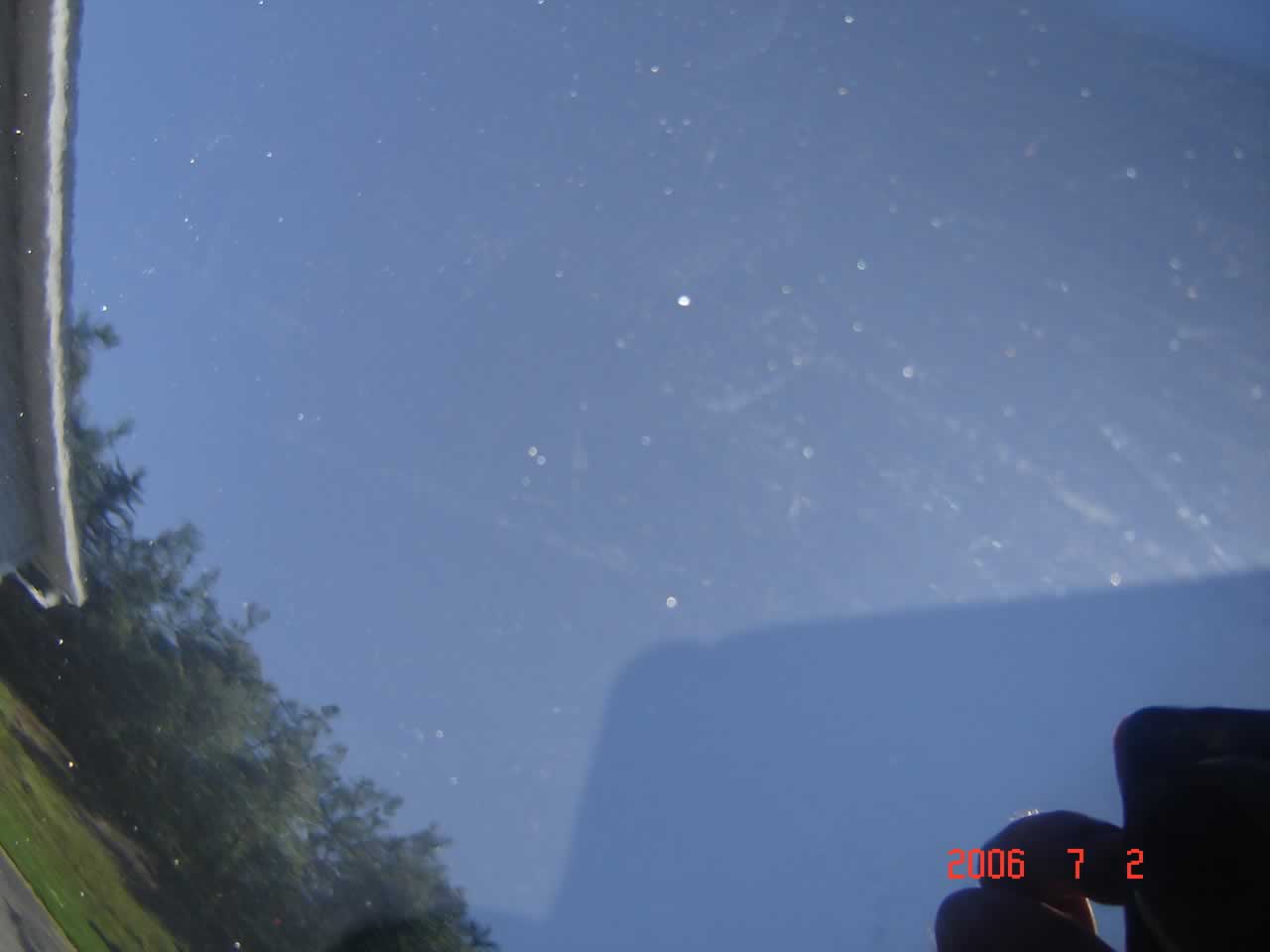

Well I finally got around to using my PC for the first time. I spent a fair bit of time reading Kevin's posts before I attempted it just cause I wanted to have half a clue as to what I was doing.
First, I want to say that I really never realized how bad my paint was until I saw some of Kevin's work. I had a severe case of spider webbing.
Anyways, here are a few before and after pics. I didn't do anywhere near the job that Kevin does, but I am sure I will get better as I do it more. I was still pretty pleased with the results.
Here are some before shots.
Attached Thumbnails First Job With The Porter Cable-before1.jpg   First Job With The Porter Cable-before2.jpg   First Job With The Porter Cable-before3.jpg   First Job With The Porter Cable-before4.jpg   First Job With The Porter Cable-before5.jpg

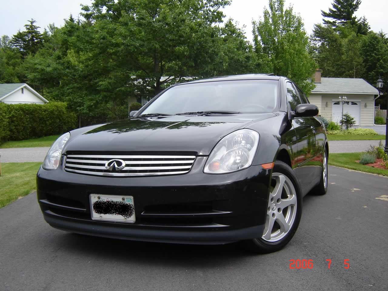

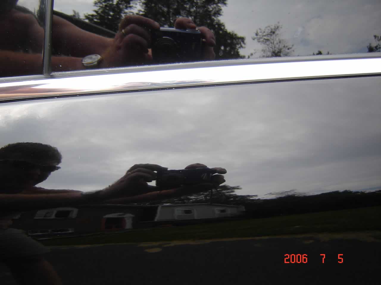

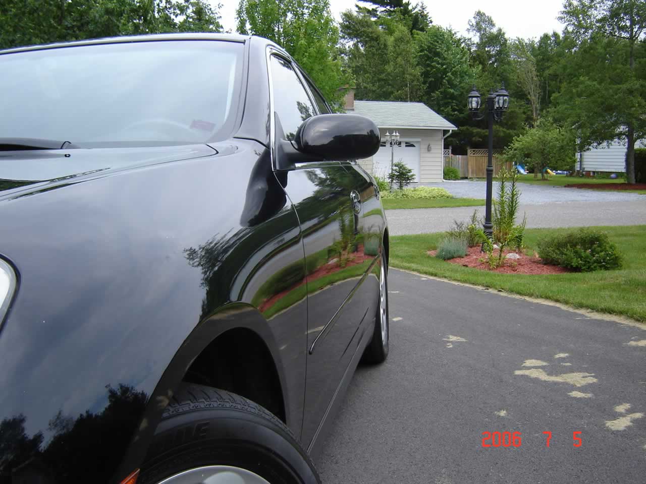

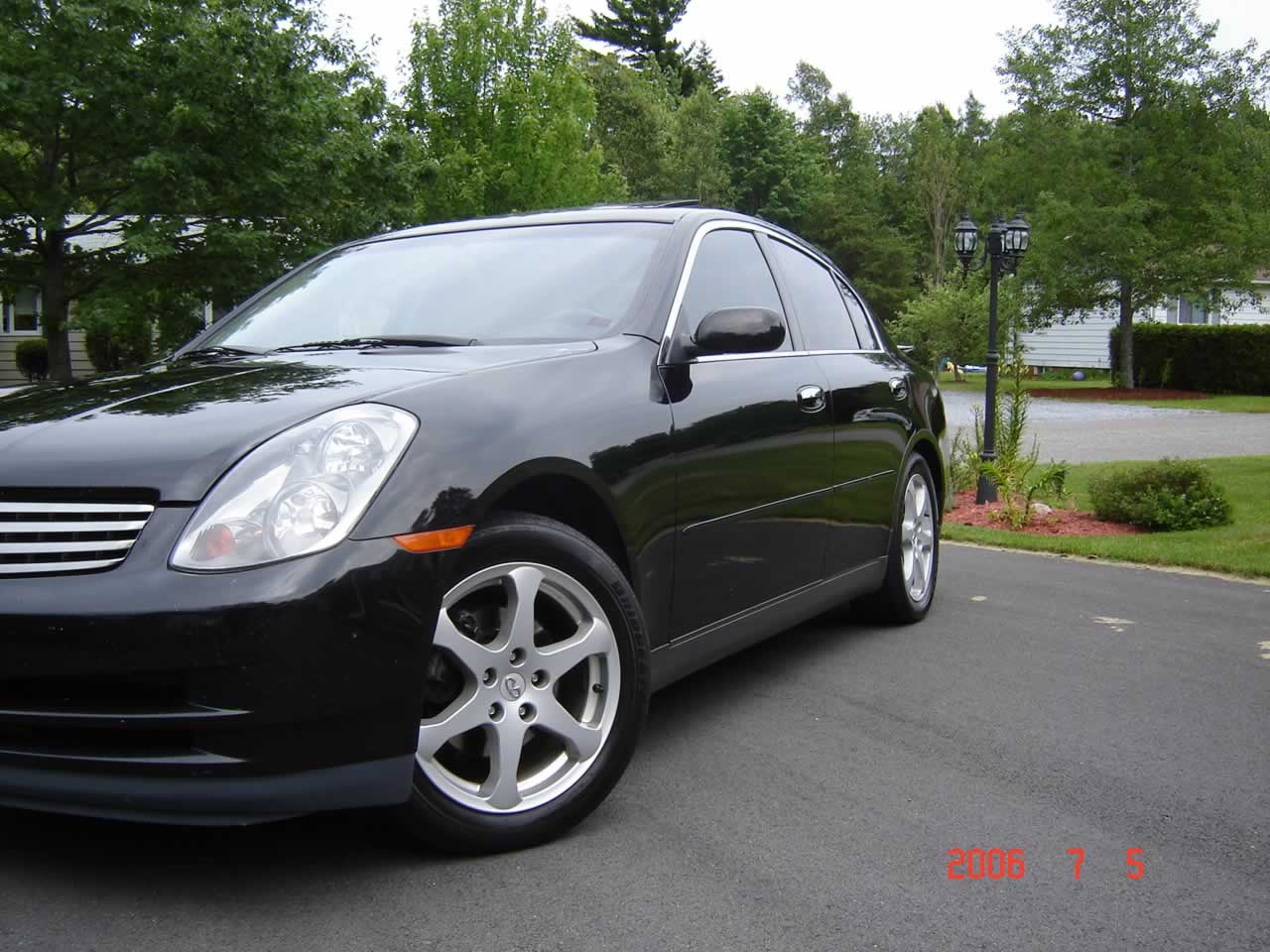

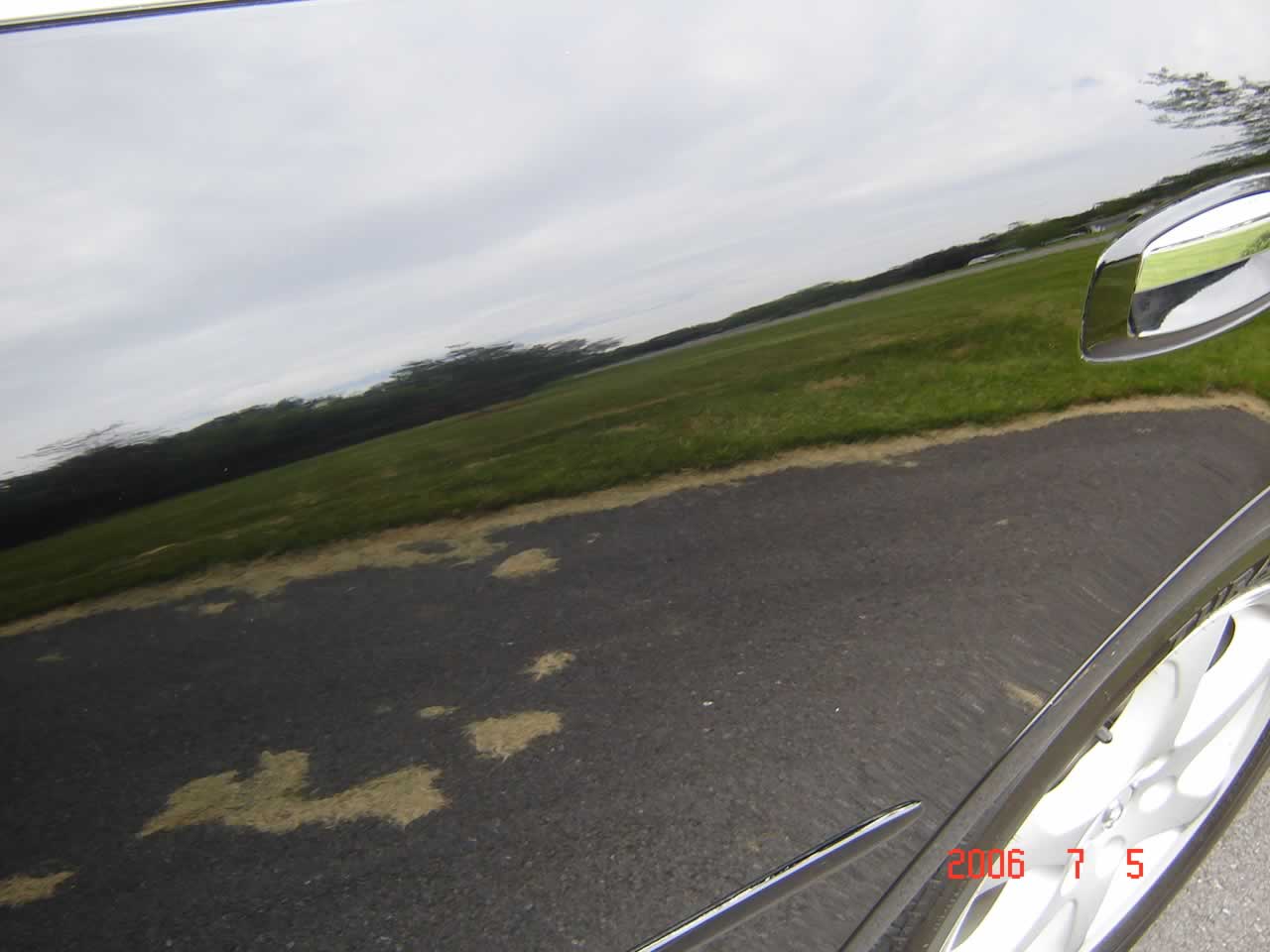

Here are a few after shots.
Attached Thumbnails First Job With The Porter Cable-after1.jpg   First Job With The Porter Cable-after2.jpg   First Job With The Porter Cable-after3.jpg   First Job With The Porter Cable-after4.jpg   First Job With The Porter Cable-after5.jpg

WOW..... nicely done Shane.
Never mind the next time... I think you pretty much nailed it this time
That looks great

Thanks guys. I spent approximately 6.5 hours on it today. I definitely have a new appreciation for how much time it takes and how good a job that Kevin does.
I have always hand waxed/polished my vehicles in the past and I seriously doubt that I ever will again. Having the PC made things easier and did a MUCH better job in the end. I wish I would of had one of these years ago.

I didn't run into any issues at all Kevin.....or at least I didn't think so. I used the Poorboys SR2 first, then the SR2.5. After that, I wiped it down with the water/alcohol mix. Once it was wiped down, I applied a coat of Zaino Z2. Is there anything else I should do that you would recommend?
