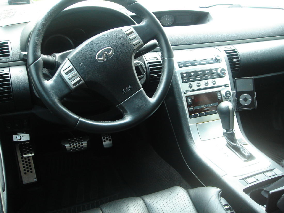

my setup

Nice! This is the setup I wanted to do but the 2003.5 dash assembles differently and that mount won't work for me. Originally Posted by Garyv01
my setup

Sorry but i dont have any pics from the oppisiite side...i took my car to an audio shop to do it but i watched...when u remove the dash the small unit is put behind in the console and you can basically choose what side you want the wire to come out of...you can put it either left or right....i thought it would kind of get in the way if i had it on the drivers side so i threw the connection cord on the rightOriginally Posted by 350Zed

Thanks..Why not? my friend has an 04 which i believe is pretty similar to yours... he and my other friends actually took his dash apart...but it took a while...its possible to be done. He also has a proclip that mounts exactly like mineOriginally Posted by BadKarma
