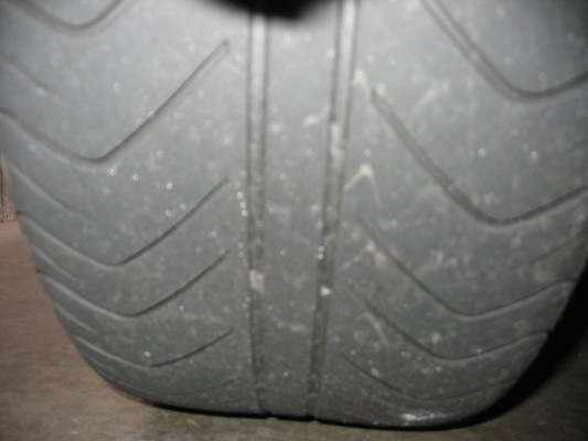

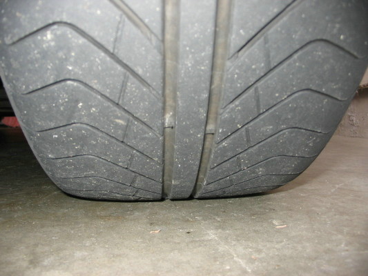

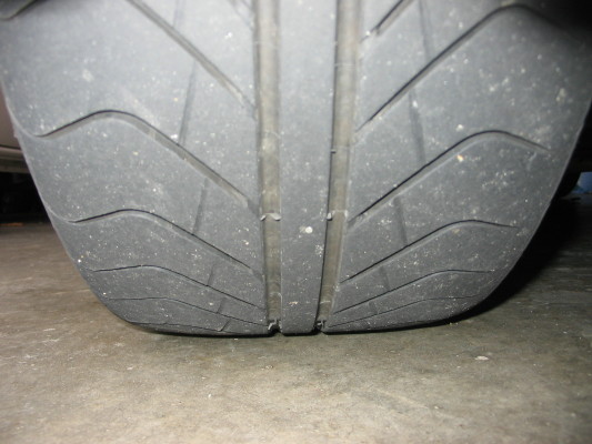

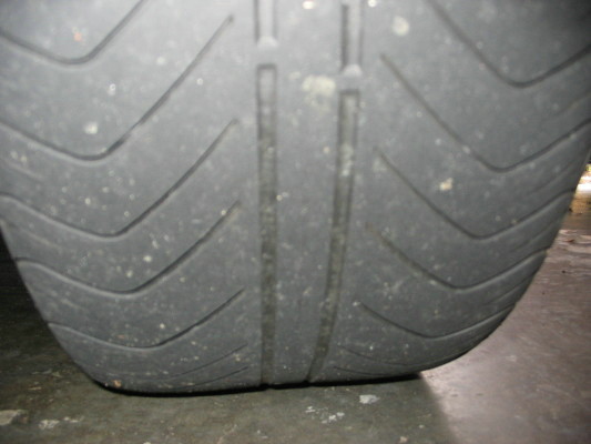

Here are some pics of my tires on the car. R. front took a beating at our track. 23.7 k on tires
r. front
l. front
r. rear
l. rear
Attached Thumbnails Messed up tire wear.-img_0423.jpg   Messed up tire wear.-img_0424_1.jpg   Messed up tire wear.-img_0425_1.jpg   Messed up tire wear.-img_0426.jpg

Deane, you need to drive that car harder. 24K and that's all the wear you have???? The only concern I can see in the pics, you've id'ed as being from the track. Otherwise, they look really good.
The toe in front, and toe out rear thing is in vogue with manufacturers, moreso than in the past, despite the fact that it has long been recognised as desireable for handling. For an F1 car, it's a must, but it seems that manufacturers feel that we are more willing to tolerate increased wear these days, than in the past.
The worst case of this can be found on the outgoing M3. I remember reading a couple years back a comparo between a c5 Z06, 911, M3 and 350Z in R&T, and the only car that thrashed its tires in their track testing, due to excessing scalloping/feathering, was the M3. Rock stable and great turn-in of course, but hard on tires.
The RE050s have a wear rating of 140, the PS and PS2s- 220. Anything beyond 20K kms is gravy.
Derek, good to see you back on the boards.
My pics aren't great and may be a bit deceiving if the tires don't look like the car is driven agressively. I doubt you would get much consensus on that from people who know and have driven with me. Generally I drive normally and then pick my times to really explore safely so it makes up a smaller percentage of hard driving. I've also had 3 alignments done in 15k and with 8k more on am overdue for another now. The rears are past the wear bars - less than 2/32 left in the centres which have worn more than the outsides despite lower pressure of 33-34 (wheels are too small IMO). The fronts still have a bit of life but I had to have them flipped at 13k to even out the inside feathering. The track messed that up however.
Most of the posters here with the 18" PS1 claim to get 20-25K+ miles on their tires so I'm well below that average. I personally have a hard time believing those claims however especially on the rears. There are no treadwear markings on my tires however I'm sure you know what you're talking about. IMHO those ratings are meaningless anyhow. My experience is there is a huge variation between brands since I've had BFGoodrich ZR's with 140 ratings go 50% longer than 220 Bridgestones on the same car. Similliar experiences with other non performance tires of different brands.
