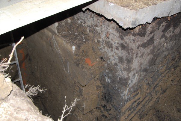

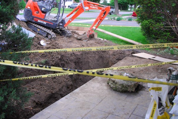

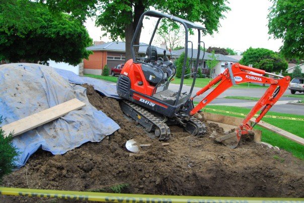

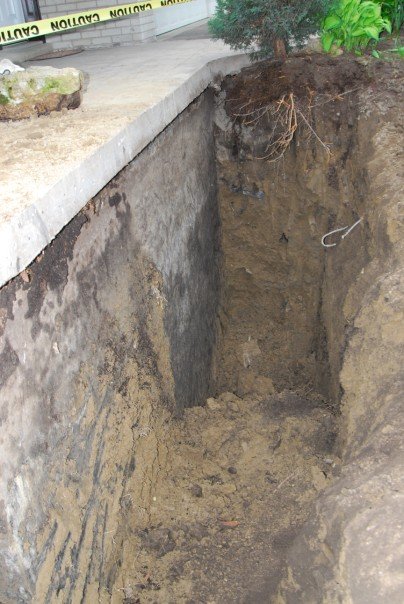

has anyone had the unfortunate problem of a leaking basement? this has got to be on my top 3 list of absolute worst things that could happen to a home owner. i've been having problems with the cold room in my home. i found out from neighbours that the previous owner added the room himself.... and what a disastrous job he did.
i had a crew come in and try to seal the thing from the outside. absolutely tore apart my landscaping but was hoping that this was the best course of action. as they dug in... i found out that an outer retaining wall wasn't completed at all!! the guy started one side and then just gave up. u can actually see it in one of the pics. other findings showed that nothing was properly sealed... and the surrounding weeping tile (where it was actually found and in place!) was installed above the footing... instead of below it!
needless to say... these things are stressful, expensive and a royal pita overall! if anyone has ever had to go through this... my sympathies to u! i also gotta say.. that if i see another drop of water coming in through that cold room... i'm throwing up a for sale sign and

yeah... it's all fixed now. they repaired the wall... sealed it with sealer (black tar looking stuff)... put a plastic membrane.. and installed new weeping tile. the house is about 45 years old. the rest of the house is fine... no problems... just this addition that the previous owner had put in.
