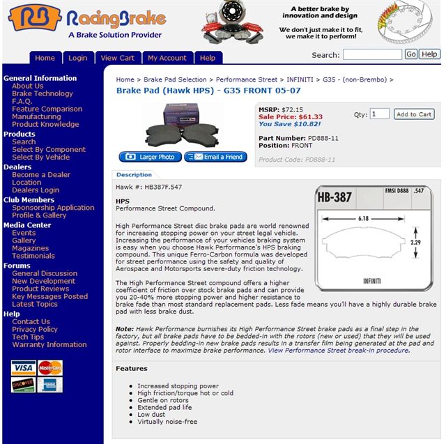

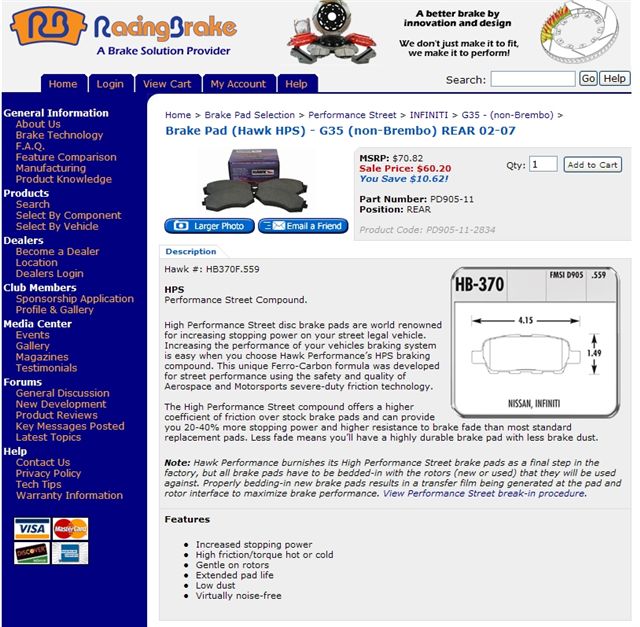

Here is the part number I ordered for my 05 6MT Sedan, hope it helps. As you can see the front pads are quite large and should be 6.18" long.
Also, I just checked the Racing Brake web site and you got the wrong pads. Yours are listed as 2002-2004 G35 Non-Brembo. See link http://www.racingbrake.com/G35_non_B...15-11-2832.htm
