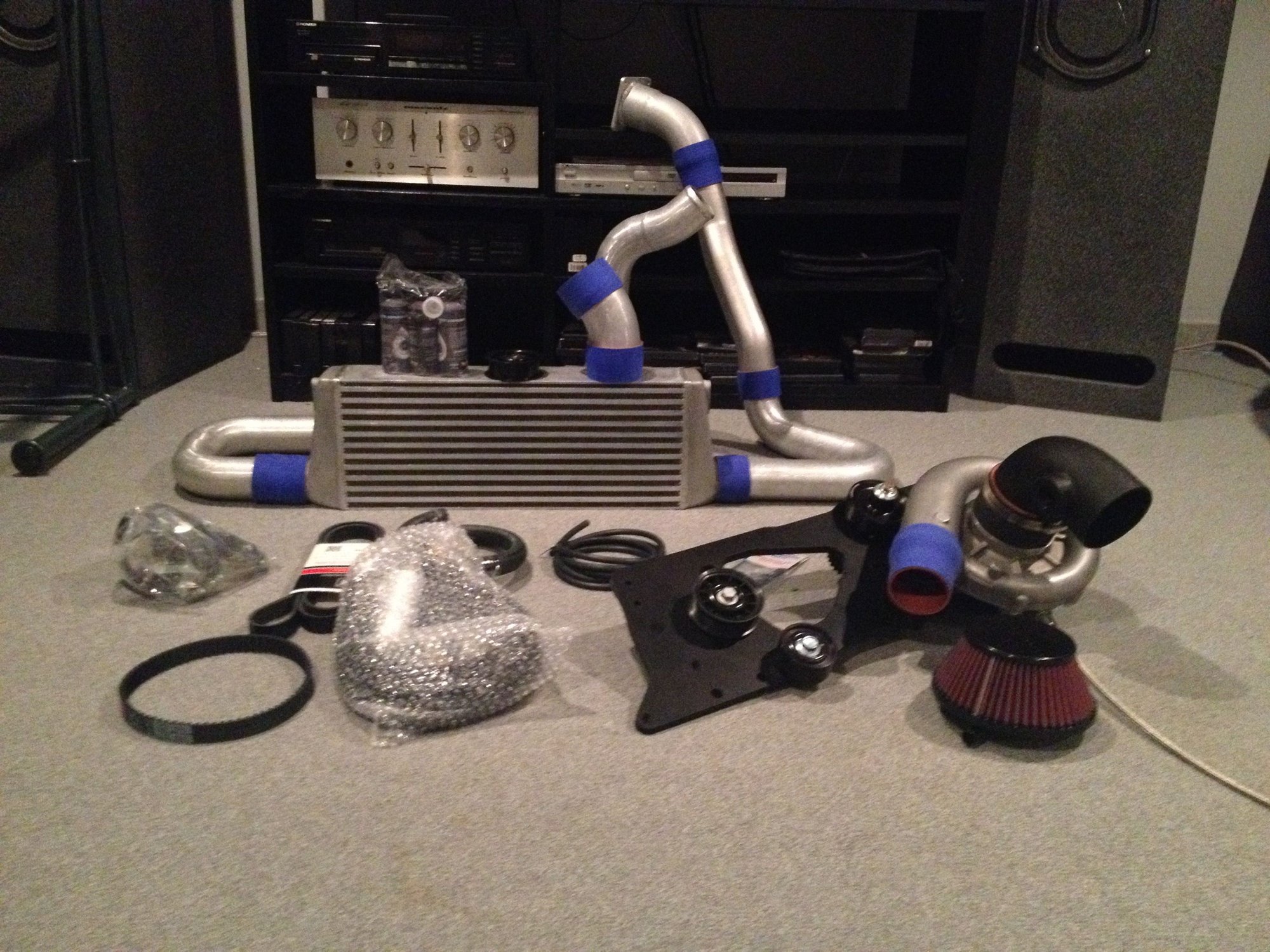

Ive received my vortech non revup complete kit and everything is there and I have questions
1) reviewing the instructions i don't see anything about assembling the cog belt idler pulley so any pics or diagrams would be greatly appreciated
2) i have the Paxton black box as mentioned i the instructions P# 5A001-353 BUT...
I also received a larg black carton labeled Unidchip with a hand written sticker 5A003-350 containing a Q+ 0148D silver device and a slighty larger black device with no real model number except it has unichip PNP technology. There is nothing about the unichip boxes in the instructions but they themselves came with instructions.
do i use both systems ? or just one of them ?

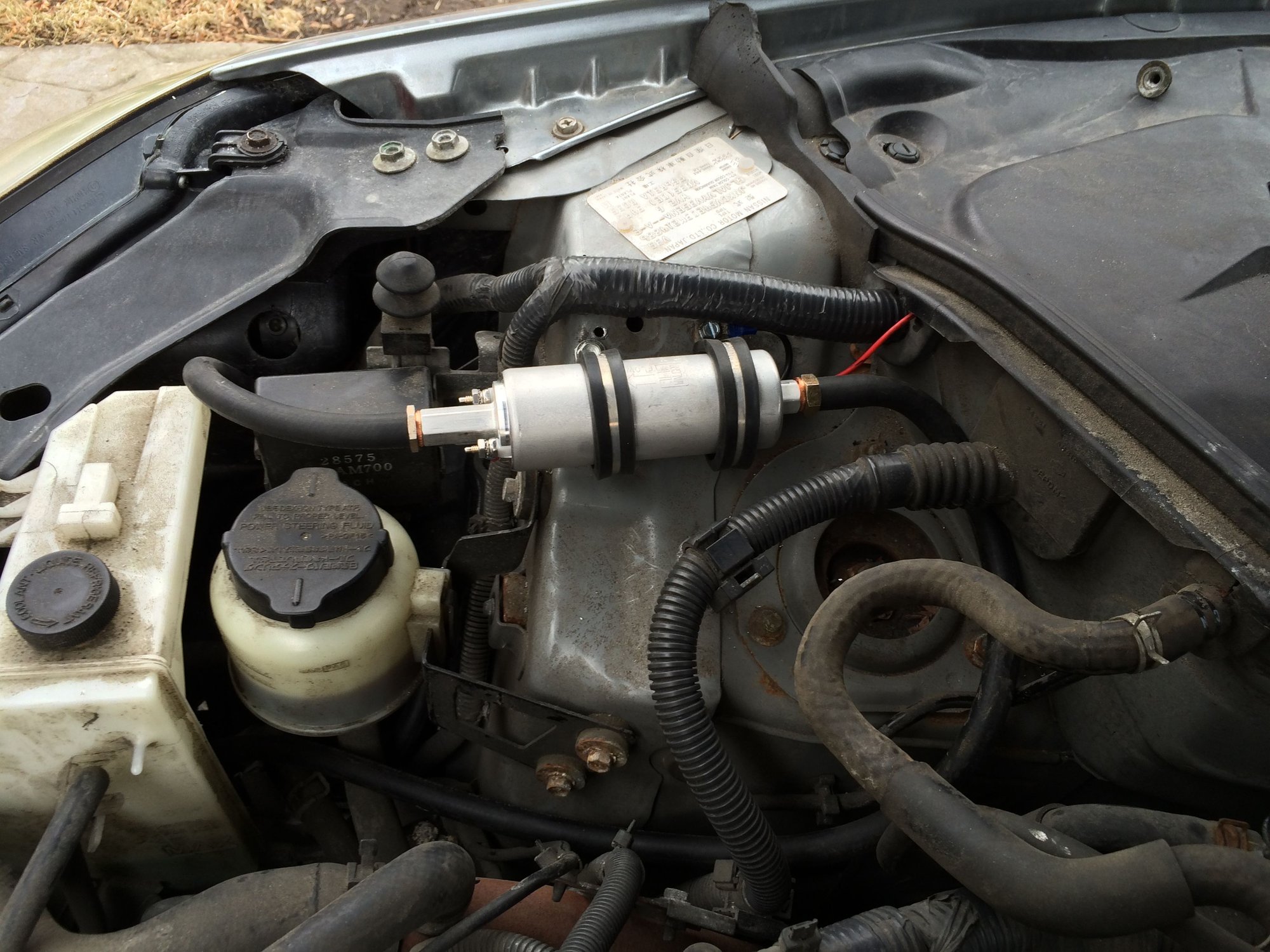

vortech aux fuel pump - new location
installed the fuel pump today... took 2 hrs because i want it high and dry and easy to trouble shoot and easier to visually check
i hope to locate the fmu in the same area

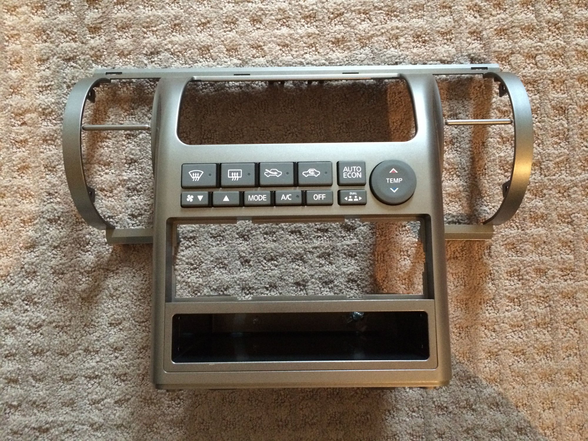

B
stereo/HVAC finally kicked the bucket so this was a necessary purchase lol
crutchfield canada around $200 delivered next day

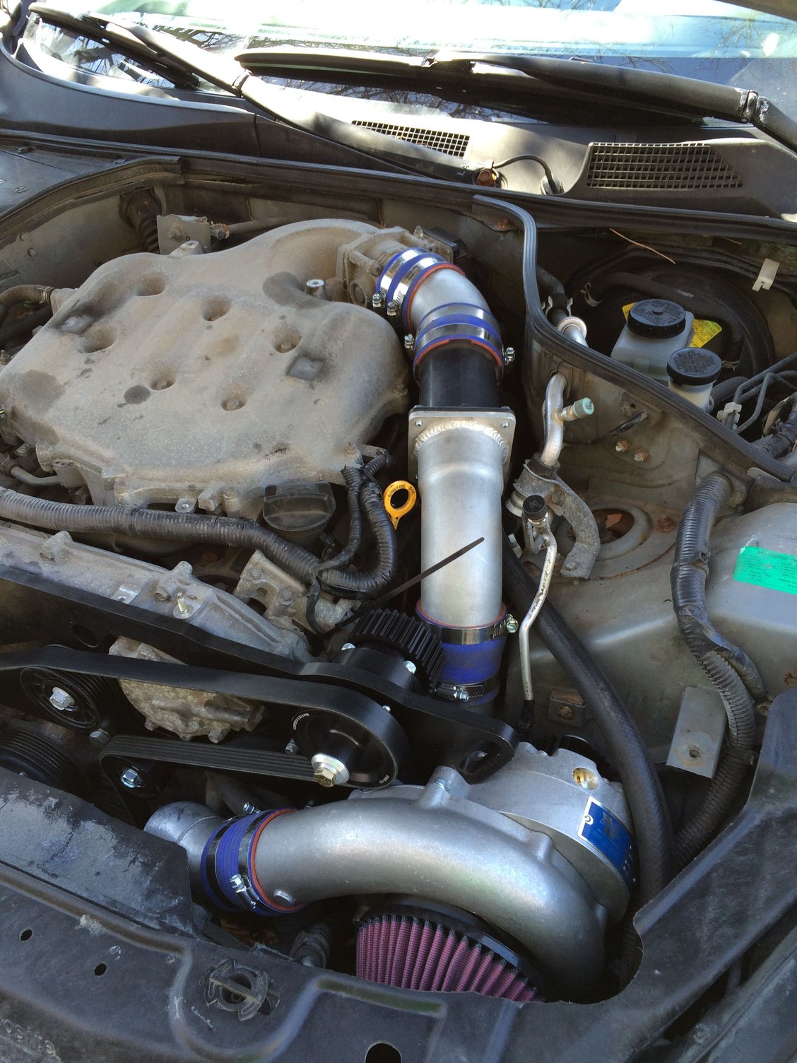

spent 3 hrs today
I fought with the tubing from the throttle body to the inter cooler
nothing lines up
i finally got it to fit... sorta...
then i fought with the main bracket
the large longer bolt supplied doesn't seem long enough... and the toothed jack shaft pulley is really close to the piping

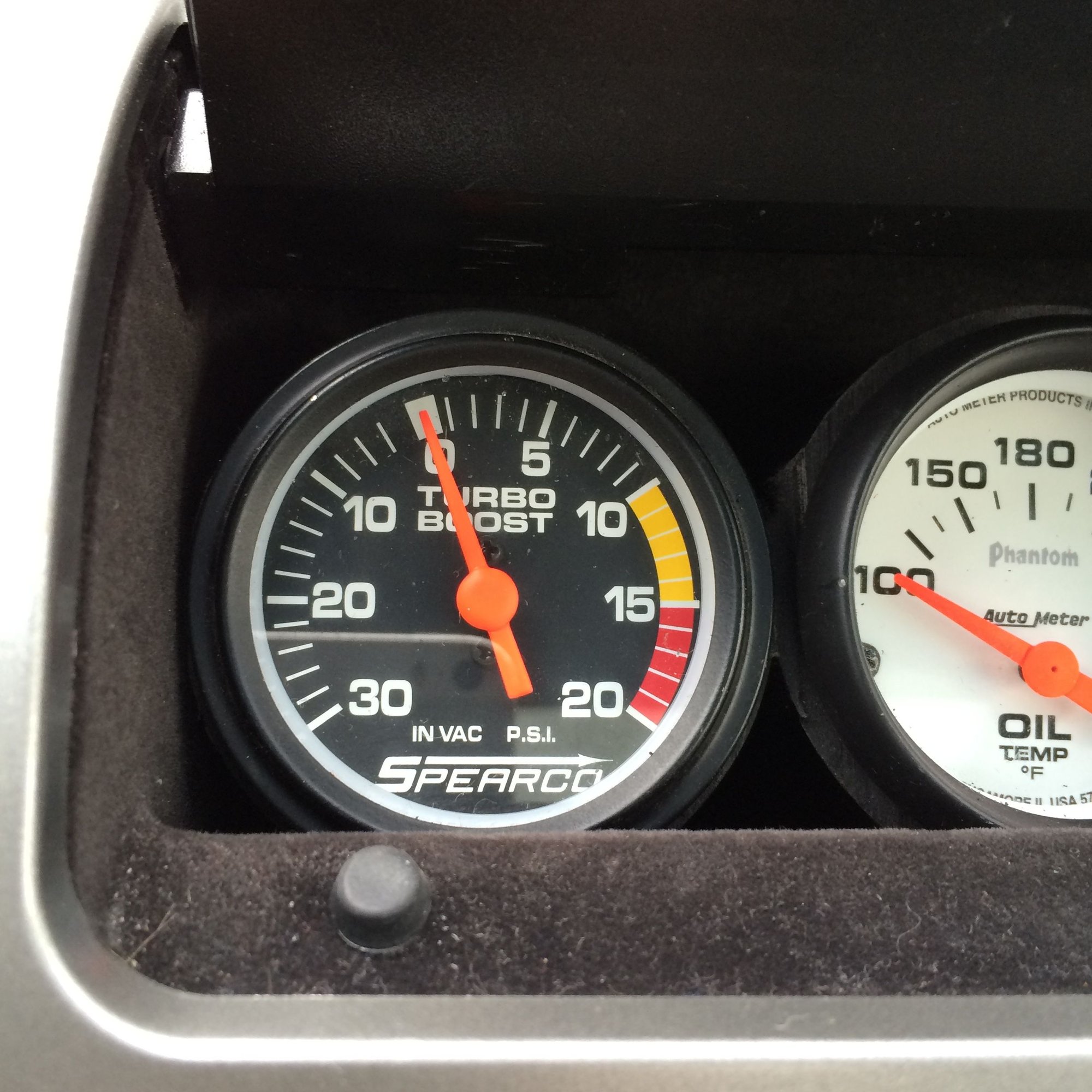

ok shes almost done !
added guages in the center console
