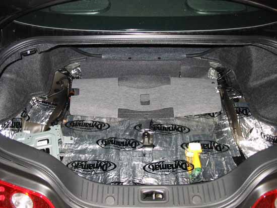

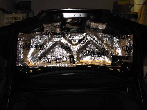

Thanks RBull Here is some picture updates
Trunk SOund Proofing-sound-proofing-002.jpg Trunk SOund Proofing-sound-proofing-003.jpg

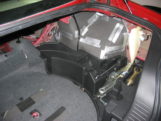

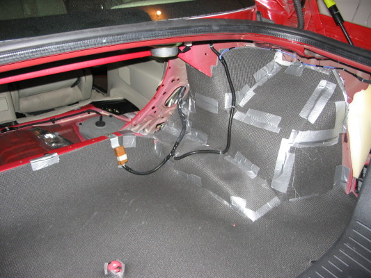

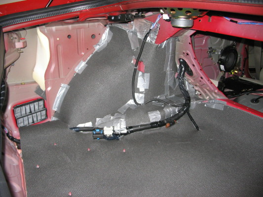

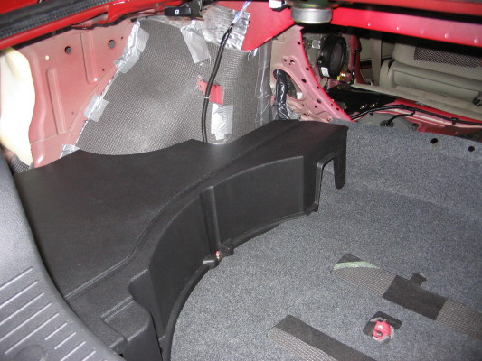

Here are few more pics of my job that was completed last weekend. Many thanks Ian. I'll be doing more of the interior this coming spring.
Please note my pics do not show the cutout in the floorpan HD foam I had to make to allow clearance for the spare tire. It needed to rest directly on the factory floor liner material in order for the spare hold down bolt to thread properly. Also had to remove the OE felt pad for the tire. I decided to do it this way instead of just putting the hd foam under the trunk mat which would have been easier to begin with.
Attached Thumbnails Trunk SOund Proofing-img_0221.jpg   Trunk SOund Proofing-img_0222.jpg   Trunk SOund Proofing-img_0223.jpg   Trunk SOund Proofing-img_0224.jpg   Trunk SOund Proofing-img_0225.jpg

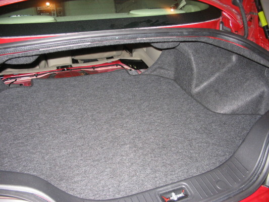

and one more of the finished product.

Great Job Dean, I actually did things a little different, I cut up the evofoam and spray adhesive it to the back of the trunk Linings. But the effect will be the same.
See your pic is now like a competition to see who will finish it first puahahaha ut i am still waiting for the custom boxes before I can go any further.

Hi Ian,
Yes I've driven it a couple of hundred km since then. It's definitely an improvement. It's still not where I want it yet though.
I find I am now noticing road noise from the cabin floor pan and from the front wheel area since the rear is better. I probably won't get to the front until next spring.
