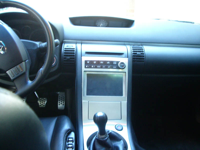

I've been working on putting a carputer into my car for a while now....it's finally almost done, and is now picture-worthy (or at least I think so!). All the carputers I've seen to this point have looked similar to the stock navi in that they've been placed in the extra cubby hole that the non-navi G35s have. Personally, I hated the look of the stock head unit, so I wanted to get rid of it. I considered putting in a stand alone navi, but I decided a carputer would better suit what I was going for.
So I bought the DD conversion kit, a Lilliput screen, all the stuff I needed for the computer, and got started right away. First issue pops its little head up....the stock amp doesn't work with something other than the stock head unit. So, I bought a new amp. Next issue....the wiring diagram says something about a pink wire, but of course, my car didn't have a pink wire! At some point, the pink wire change colors, so I had to guess and check. But I found it, so I was happy.
A couple more little issue, but nothing big. Then I decided I hated the way I mounted the screen in the DD kit, so I found a guy who would machine some aluminum for me exactly how I wanted....I got that back from him and it fit perfectly, so all that was left was to sand it to give it the brushed aluminum look much of the rest of the car has.
I've got GPS and wireless internet in there....I may put in bluetooth for a keyboard and whatnot, but I haven't decided really. I haven't played with many of the frontends yet, so that's my next order of business. Oh yeah, and getting my steering wheel volume controls to work....I'm determined to do this because I LOVE that feature!
So anyways, here are a couple pics that I have. Sorry, I didn't document the entire journey, so the final product will have to do.

it looks really, really good!

Very Nice looking.
Can you post pic's of your mount?

I don't have pics of the mount and it's a huge pain to rip the stuff out. However, I do have the diagram that I used to have the guy machine the aluminum for me. If you wanna check it out, let me know and I can send the file to you.

Looks good, really cleans up and simplifies the interior.

Looks good! I like the screen in the DD spot. Not an option for me; I have a head unit, and a couple of gauges and buttons in my DD spot, and the screen in the navi cub *with the mp3car G35 mount), but I still like what you did. Looks very clean.

I may be pulling the screen out this weekend to clean up some of the wiring behind the screen.....if I do, I will take pics of the aluminum pieces I used to mount it. I will post those if that happens this weekend....otherwise it will happen sometime in the next couple weekends.
