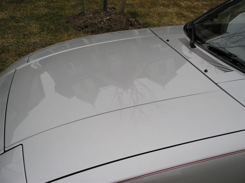

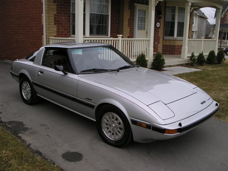

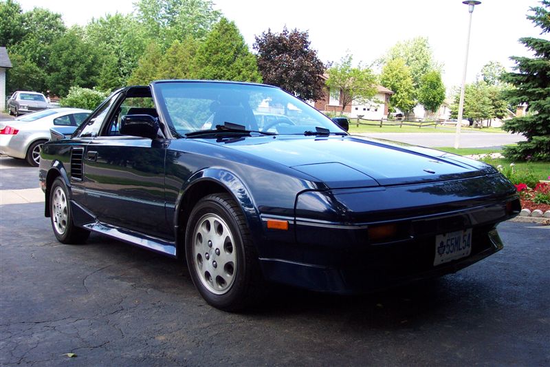

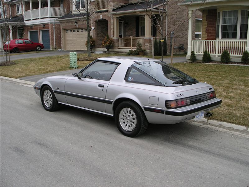

To dispel the new car/old car myth, here are Zaino'd 85 RX7 GSL-SE and 87 MR2 photos. On the RX, we did two coats of plastic polish to bring the black plastic on the taillights from oxidized whitish grey to what could hardly be distinguished from brand new shiny black. (20 year old plastic!)
