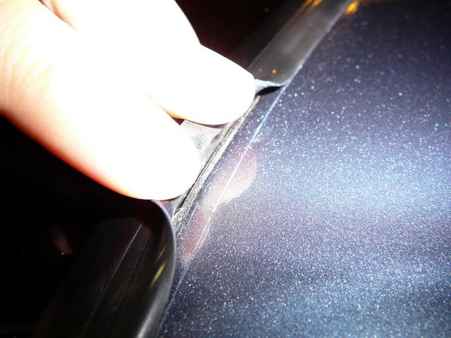

got back the car today. The lady that dropped the car off said they got off the stains and claimed that the roof was not repainted but could not provide the work order cause the manager was on vacation...
well the stains are gone but it appears they repainted it or recleared it. They were supposed to tell us if it was to be repainted cause we would have refused. The repaint seems a bit odd though i think it need to be buffed not to mention it appears to have more metallic in it then the stock but the color doesnt match real well in the shade. Though underneath it has a line that shows it has either thicker clear put on it or paint and clear as you can see in the picture. We are going to try and demand a new car and hope everything works out but I doubt they will let us get a new car. I just feel sick about this whole situation

they may have buffed it out. the line that you see under that piece of trim may be just dirt or wax built up. try lifting the trim as you did in that picture, and use a q-tip with wax to see if that line disappears. if so, they buffed it out. if you can feel and layer of paint with your fingernail, it has been painted.

tried it out, the line is less noticable but i can still hear a change in thickness when i scratch my finernail across it, not to mention the qtip turned a little blue Or could it be a realllllly thick layer of glaze or a colored glaze they used to buff?

back to topic .... You should be able to demand a new car if it has been repainted... I had some haze in my paint as well when I got mine, took it to get it "buffed" out at the dealer, I got it back with a bunch of swirl marks... so I just did it myself .... If you really wanna check to see if it has been waxed or painted... you can try to get a microfiber towel, wet it with Dawn and water, and wash a small area where the surface is uneven... if it comes off ... its a thick coat of wax.. if not then guess its paint...

They called today. I wasn't home (was on a job site visit and got a job offer today ) my dad talk to the GM. The GM told him that the detailer made a mistake and painted the roof and he acknowledges that they shouldn't have painted the roof. He doesn't want to give us a new car cause he has to sell our car as "used" . He wants us to give him another chance and to paint the roof at a "professional certified" shop. My dad told him repeatly that we want a new car but he didn't budge. My dad told him he will call him back on monday...
