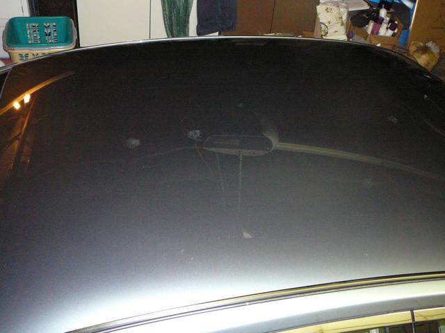

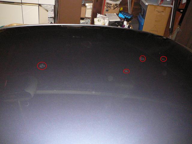

Hi,
My parents just bought a new 2006 G35 sedan Lakeshore Slate from Infiniti of Montclair, They purchased it putting a lot down, and the next day I noticed that there appeared to be what looked like 4 bird poop etching on the roof of the car. So apparently they sold the car with the damage already on it and the person that intially detailed it didnt catch it or didnt tell us. My dad calls the dealer and says they will take care of it and that it will it will "buff" out. They said they will send it out to a prof detailer. They are going to pick up the car this Monday.
I was wondering if anyone has had paint damage like this and it really buffed out?

We bought a new G35 Lakeshore Slate/Stone sedan, this dealer is the only one to have this color combo. Well we bought the car we looked it over but missed that there was damage on the roof of the car, its hard to see at eye level because of our height and it was along the center line of the roof. We noticed it by standing on a ladder. The damage was what looked like bird poop that had been baked into and went through the clear. http://pics.bbzzdd.com/users/annihilator3001/roof.JPG , close up of 2 of 4 http://pics.bbzzdd.com/users/annihilator3001/etch1.JPG , http://pics.bbzzdd.com/users/annihilator3001/etch2.JPG . The dealer said they take care of any problems that arised in a resonable timeframe which we did we contacted them right away.
They said they take care of it, they took the car the car and they tried to buff it out but it didn't come out. They said it will wash away next time you wash it, which of course it didn't. We contacted them again to fix it. They took it again, I signed a work order that said detail, I asked specifically what was going to be done, I assumed a wetsand or a airbrushed at worse. The lady that pick up the car said and I quote "We can't do any major work if we don't get authorization from you" (well my dad his car so his authorization). They had the car a few days and no one called us or left any message so we assumed everythings fine. They finally brought back the car, and the same lady said they buffed it and detailed it and got all the stains out, we saw it and thought good and she said that they did not repaint the roof and the value of the car was not depreciated but could not provide a work order that said what exactly they did becuase the manager was "on vacation".

will not buff out. i had a black z that i left outside while on a trip. bird pooped on it and the sun baked it in...looked exactly like your close up pic. the acid has eaten into your clearcoat, there is no buffing that out.

it's not coming off. I have the same problem with my hood. It might not even be bird poop. Once the clear coat is cracked, the only way is to get it painted again. I still have that problem on mine.

You could wetsand it and buff it to try to minimize their appearance; odds are it won't be completely removed without a repaint.

I'm not 100% convinced those can't be removed by wetsanding/buffing. FWIW, wetsanding/buffing, if done properly, removes only a small fraction of your clear - definitely not enough to cause any sort of failure.
