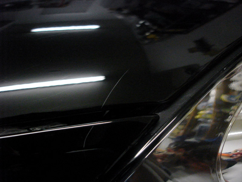

hey guys i found out i have these tiny scratches near my front fender, the scratch isnt that bad but you could see the white paint, underneath my Black paint. How can i fix this? should i use factory touch up paint? if so how do i apply it on to the scratch?

search on a product called langka. nothing but good reviews from everyone.
If you go the touch up route, here is a quick and dirty writeup of what I do:
Soak my sandpaper in water overnight: 1500 grit, 2000 grit, 2500+ grit
Prep the surface by cleaning the scratch with some water & isopropyl alcohol
Using a toothpick, direct the touch up paint into the scratch, and over apply the paint in the effected area.
Let the "blob" cure for a day or two, then revisit with your sandpaper.
Depending on how much paint was used, wetsand the area down and finish up with the finer and finer sandpaper.
The scratch should be completely filled and smooth, with a haze from the wet sanding.
Take out your favorite cutting polish to remove the wet sanding marks and follow up with a finishing polish.
After polishing, be sure to protect your paint since there obviously isn't any protection left.

try a fine cut cleaner to remove/then just a polish/wax and or seal.

nce write up man, i do that same thing, but only thing i do dif is when i am sanding i have a spray bottle with me and keep wetting the surface while sanding, hence wet sanding
