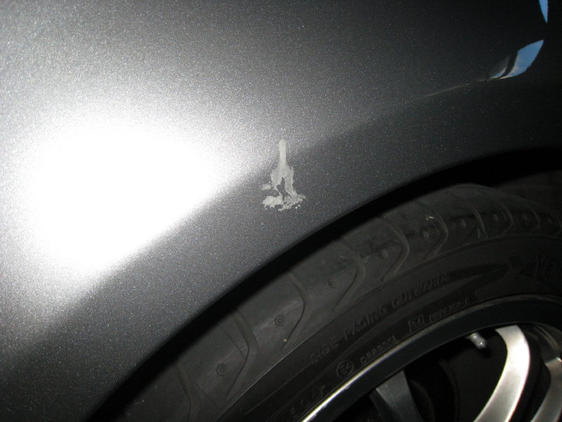

Any suggestion on getting this glue like gunk off my paint job. I have no idea what it is as i bought it like this. Take a look at the pic

try prepsol, they sell it at your local auto body shop, but first i would try soap and water.

soap and water, then try a bit of rubbing alchohol on a MF towel very lightly rubbing...
It should work... now after you get it off the alchohol will totally take off any wax... make sure to re-wax the area to protect it...
Oh.... have you tried to clay bar the area as well?
Good Luck.

try GOO GONE you can buy that at AUTO ZONE. should work

ok guys, soap and water does not do the job. its seriously stuck on there so well.

I may be an idiot, but whenever something was stuck on my old car, I used gas and it took it right off with some rubbing. Just be sure to wipe it off quickly because I would imagine it would hurt your paint if left on there...

have u tried a claybar?

CLEANER WAX OR RUBBING COMPOuND... Gas and alcohol? wtf?
Try cleaner wax or scratch removers 1st.

goo gone or clay bar should do the job

Clay bar first...if that doesn't work then try some"Bug and Tar" remover.
Stay away from gasoline or varsol/paint thinners.
Is the substance hard or soft and plyable? It looks like silicone in the picture.

Isopropol alcohol in a 50-50% mix is used by many GREAT detailers to remove polish residue during detailing. So, it is not unusual by any means. I probably wouldn't use gas. You may want to use some locally available Scratch-X made by Meguiars. I wouldn't use rubbing compound either. You would have potential for instilling some marring.

You may also want to try a little WD 40, It works on removing everything from tar and gum to stickers etc. Put a little on a soft rag, apply on the spot....then try lightly rubbing the area.
If not try a mild polishing compound......
It may be something that ate thru the clear coat, and its discolored.
Good Luck

I've gotten soemthing like that off my truck before using Goo Gone or a Claybar.

Sorry for my ignorance. What is claybar? Is this something I can buy at the store?

have u tried wax yet
