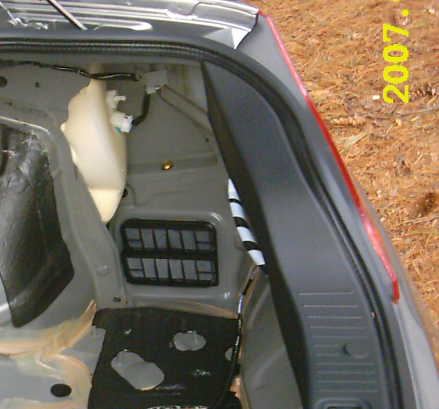

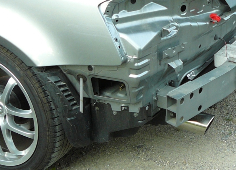

Hope this helps.
There are two holes on each side of the car inside the trunk right behind the rear wheels which is covered with a very crappy one way vent to let air out. I had taken these out for a few weeks and noticed break dust and rubber building up very rapidly inside the trunk. I put the vents back on and now it's not building up again.
If you think it's that much of a problem I suppose you could seal them completely with tape or something else.
As you can see on the outside shot, not only is the vent behind the rear wheel but the air vent from the tire pretty much directs dirty air right to it.

huh, interesting... I do know that vent from installing my XM.. I'll take a look at that and see what sealed vs open does. thanks

Originally Posted by GWord256
Hope this helps.
Um.. that's for the trunk but I don't think he's talking about that right? When he says back I think he's talking about the backseat area and the headliner.. I don't know am I missing something here?
