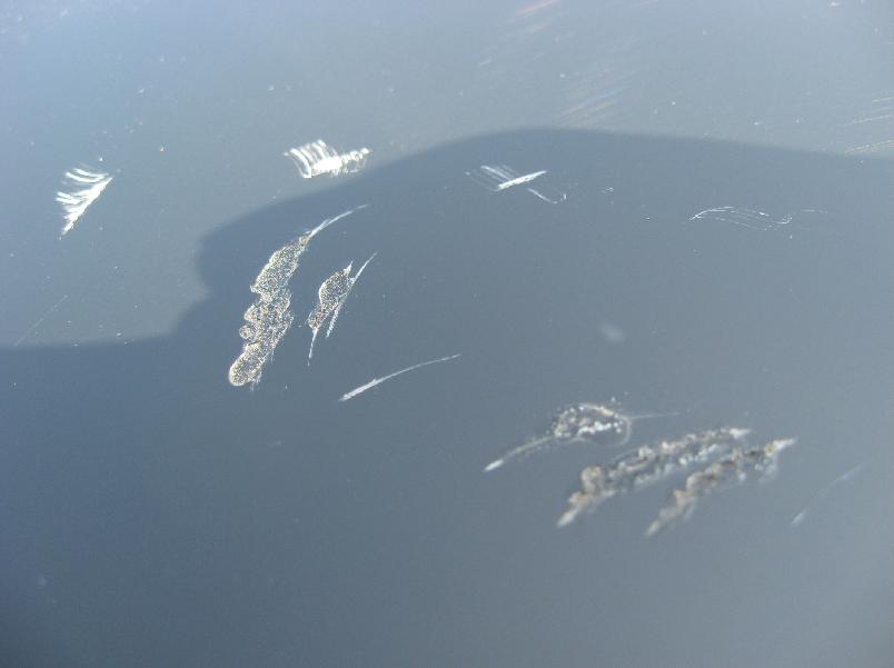

So its a beautiful saturday out. 75*, no wind, and I've got the whole afternoon and a garage to myself. I couldn't have asked for a more perfect day for detailing.

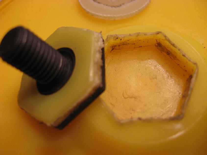

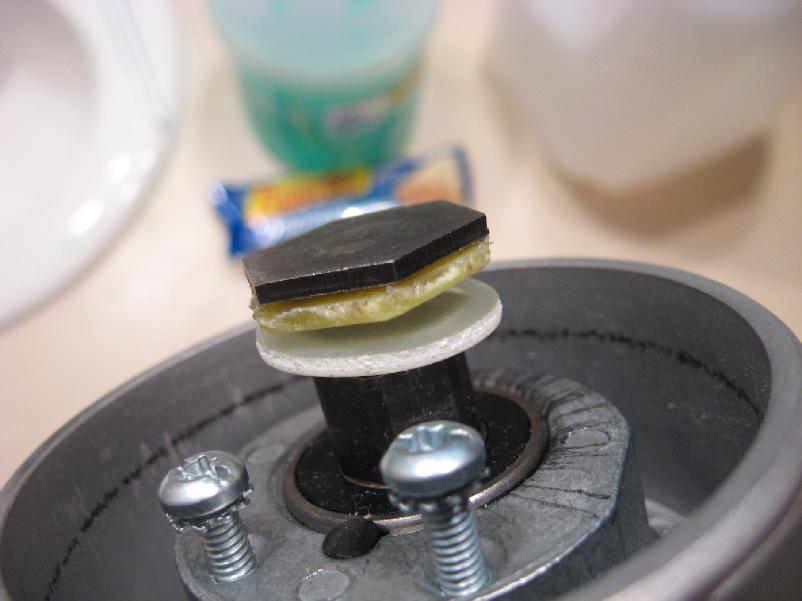

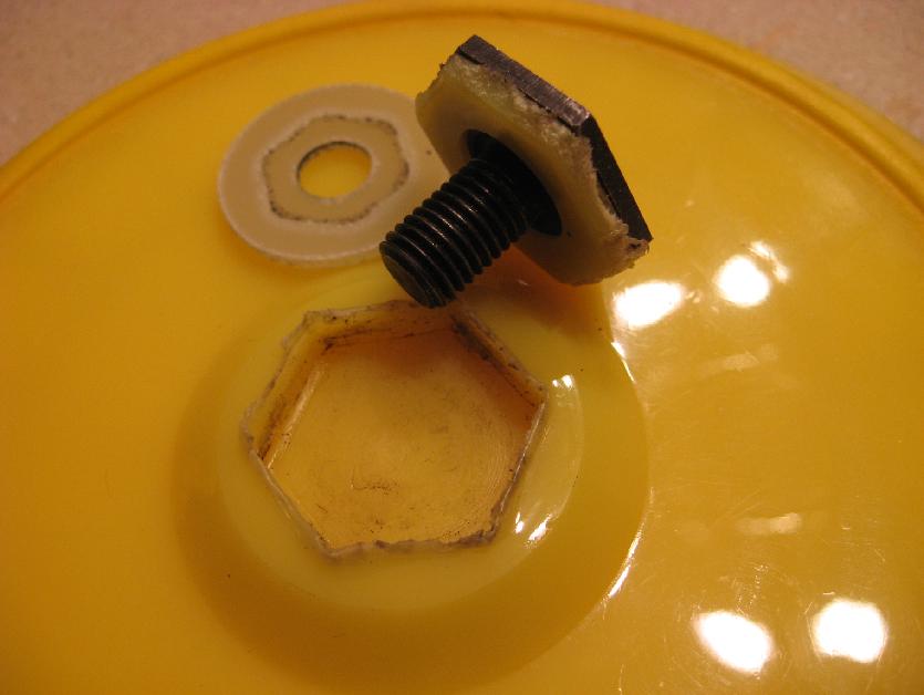

So there I am, polishing away on my hood with the PC7424 at around 5 speed. Everythings going well, until I feel a funny loose excess vibration. Before I knew it, the backing plate flung off, and 1000rpm metal meets Infiniti paint. Here are the results..

I emailed Eric from Lake County MFG and Im gonna try to get them to pay for the damage...Apparently, they had a batch of bad backing plates. I also emailed George from DI and he says hes gonna send me a replacement (Thanks George!)
Just a heads up to all you PC users...if you feel a sudden loose vibration...STOP!!!!!!

They have a defect on the 6" backing plate, this case was an old case around 3 -4 months ago... when you get ur new one, check around the metal part where it connects with the yellow plastic.
