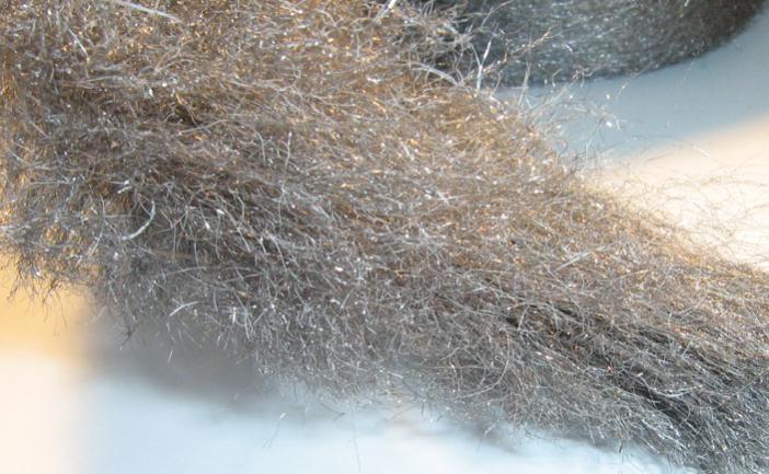

What I do when I detail cars that have heavy water spots or soap spots on the windows is use either a razor with Invisible Glass cleaner or a like a Brillo pad. I cover the glass completely with the invisible glass cleaner and scrub it with either the pad or scrap it with the razor. It always works and leaves the glass brand new.
REMEMBER NOT TO DO IT WITH THE GLASS DRY (This WILL scratch the glass, if done while glass is DRY) Cover the glass in glass cleaner First.

What exactly is a Brillo pad? I actually bought Invisible Glass today just to test it, but I will give your advice a try tomorrow. Will Invisible Glass damage the top of my dash?

Invisible glass won't hurt the dash, I have used it for years, just make sure you wipe the dash after you are done cleaning the glass. Afterward just wipe with towel. A brillo pad is basically a ball of steel wool.Just spray the glass with the glass cleaner and use the steel wool to scrub the glass.

Is it necessary to use the Brillo pad? Couldn't I just spray the windshield down and just use the razor?

Ya you can a razor the steel wool just makes it a little easier. The razor works good too.
