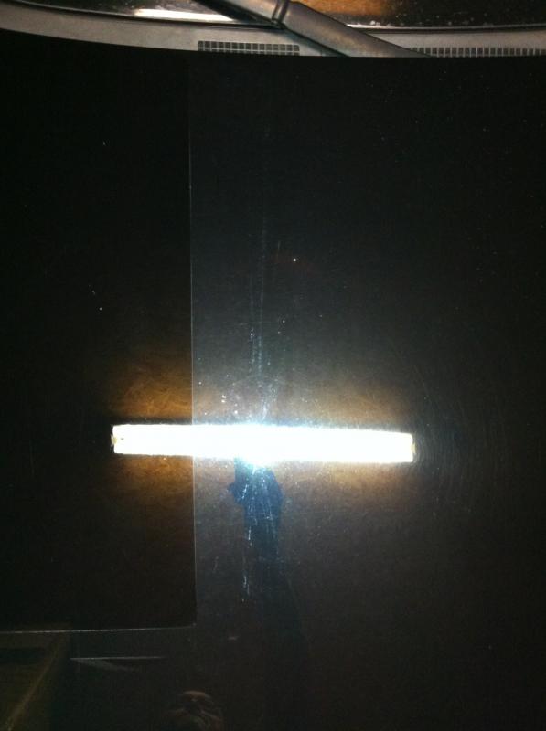

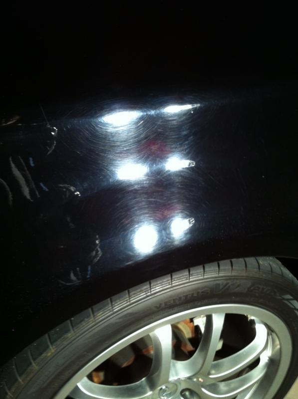

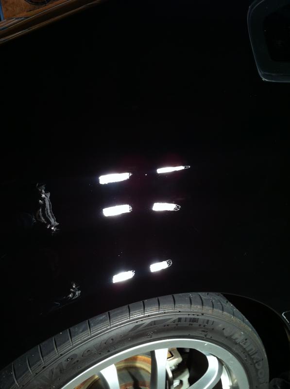

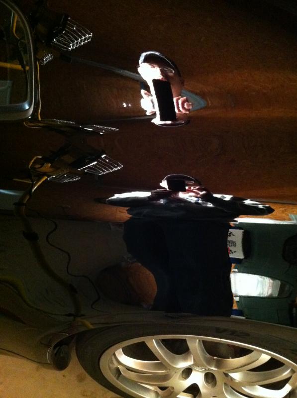

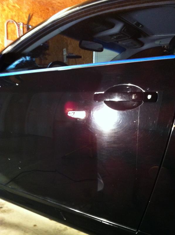

I saw some other member's cars after they polished them and realized my car didn't look too hot. Ordered a Porter cable polisher, pads, Meguire's M105 and M205 and Merenza sealant. I washed the car, did a clay job, washed it and then started with an orange pad and M105. Followed by M205 on a white pad and then washed and wiped it down with IPA. Finished up with the Merenza sealant. This is the first time I've ever attempted this but my car needed it and I didn't want to dish out $500 to $600 to get it done. After all was said and done I should have spent the money. LOL. Let me know what you all think.
Before

After using M105 cutting compound.

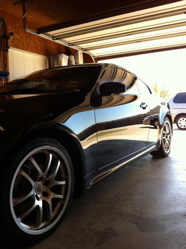

After M205 polish and sealant

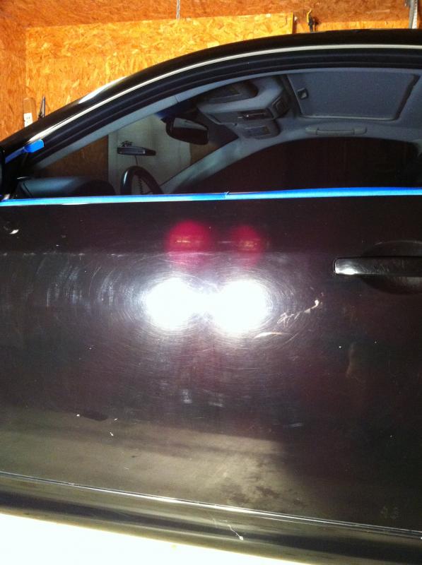

Drivers door before starting
Drivers door half done with M105

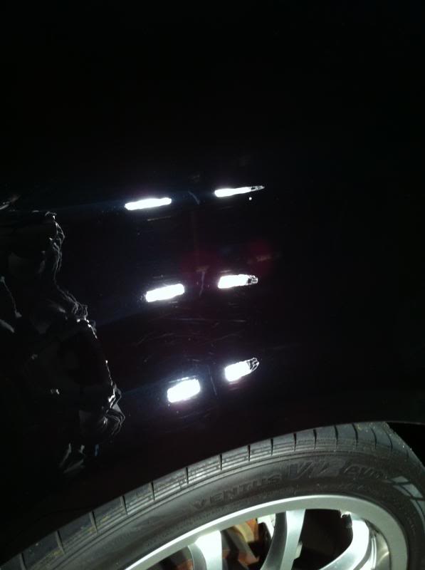

The hood after doing my test spot to see what I need to do.
I liked the results even though I only achieved about 85% correction.

Almost a mirror finish.
