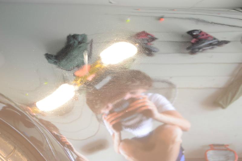

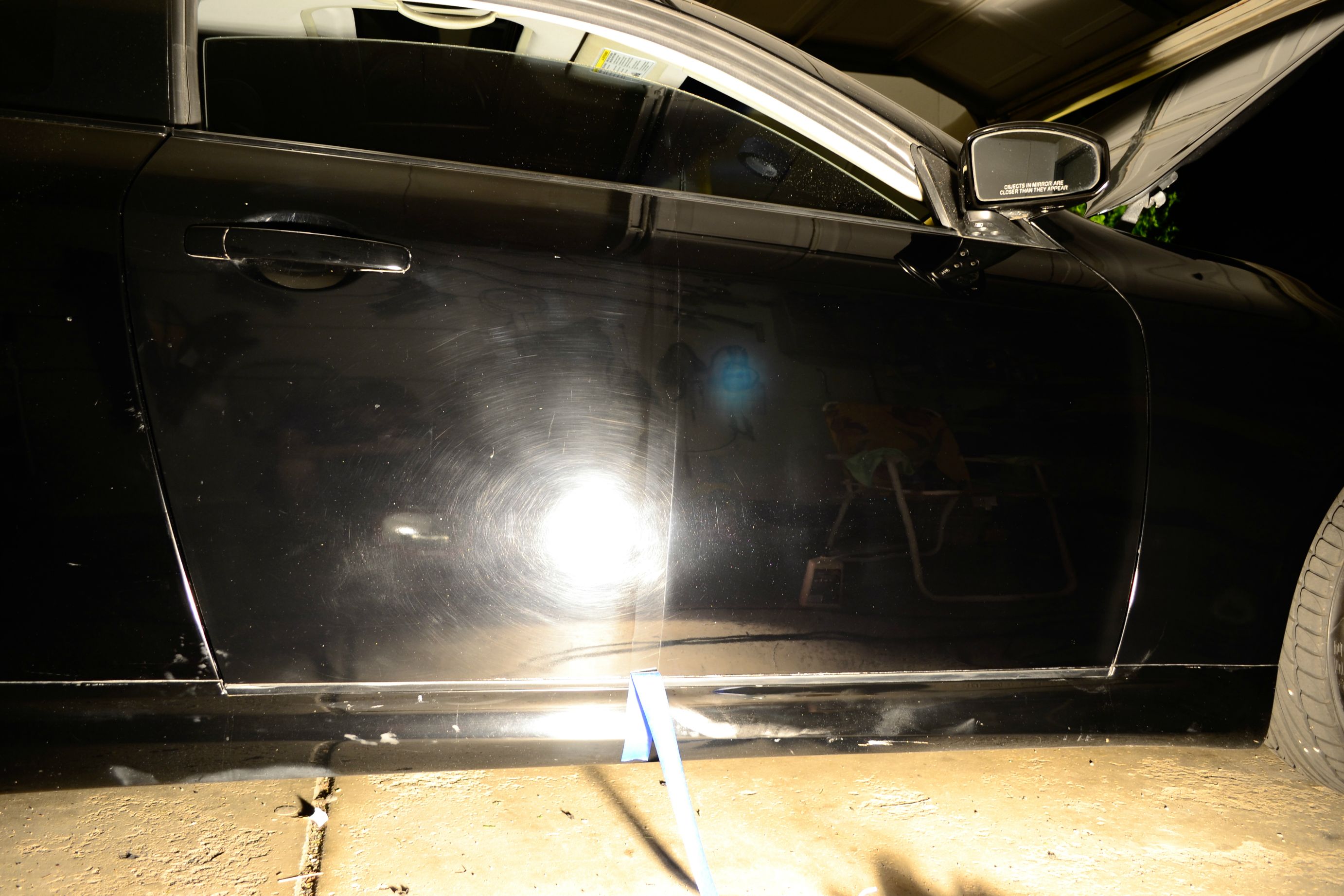

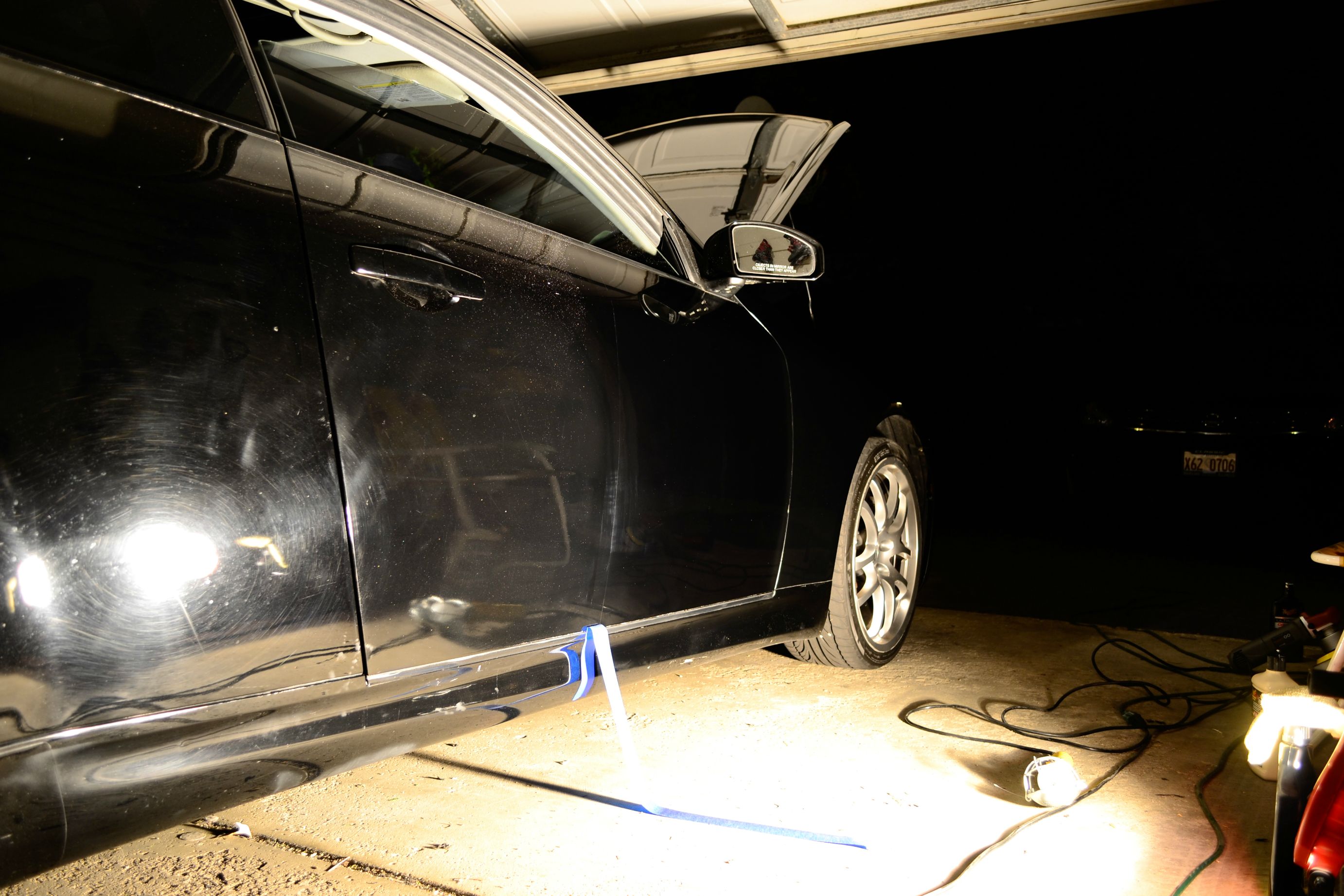

Well today was an awesome day, temperature was perfect, so why not call couple friends over and do some car cleaning. Well when they came i slacked and got no work done. Couple hours later i got my **** together and its time to restore my 2006 G35 Coupe that spend most of its life in Florida, Miami Beach.
Only have 4 pictures for now but i will update this as it goes.

wow, that paint looks really neglected. good job so far though! i too have an 06 OB coupe. it's a pain sometimes, but it's so worth it.
good luck. post more progress pics.

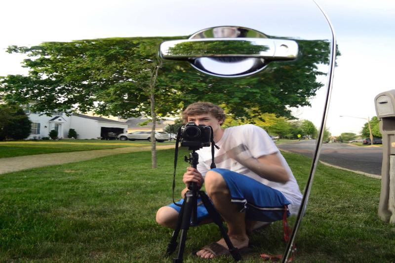

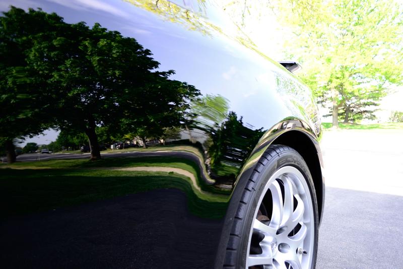

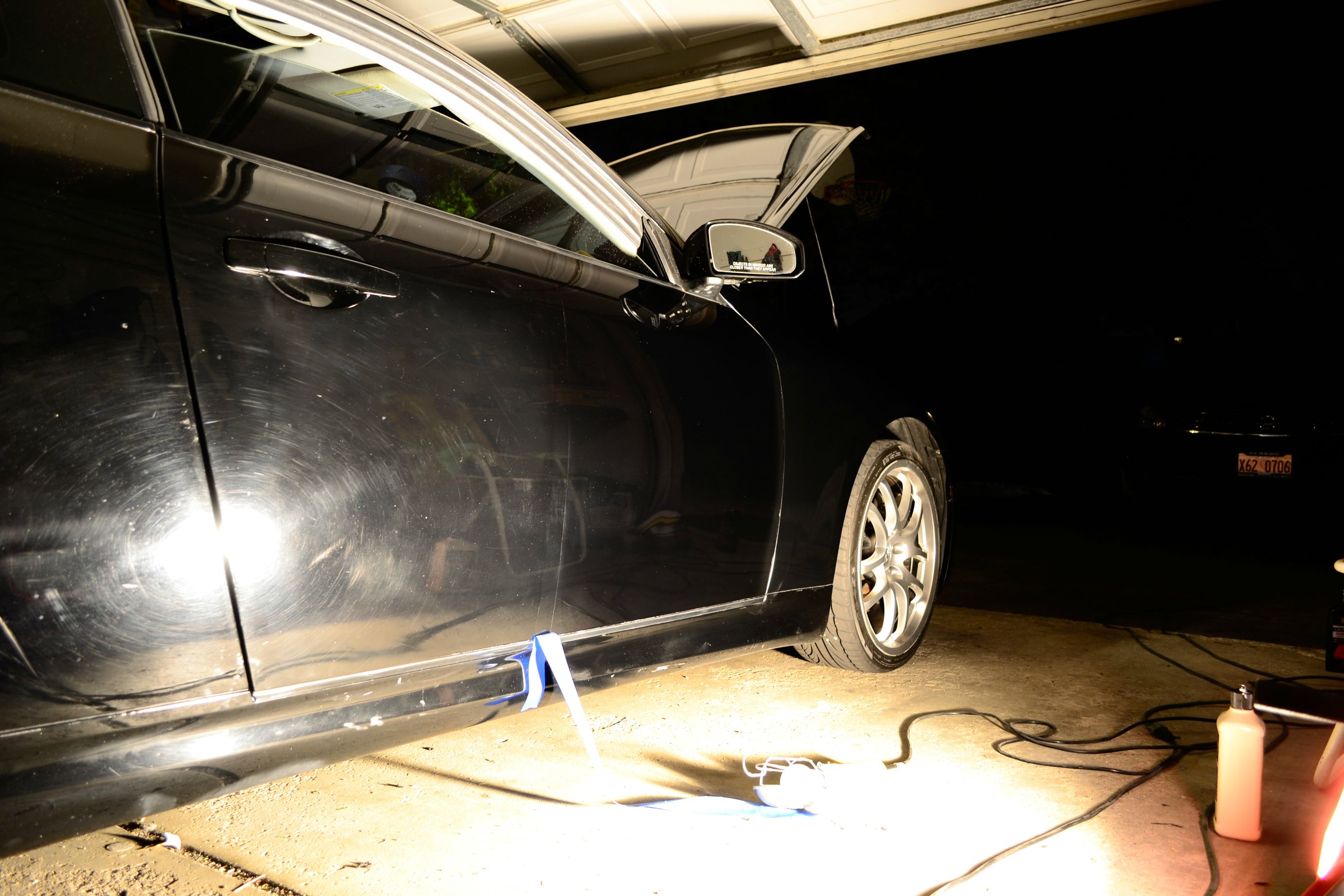

Seems like this car spend most of its time at dealer free car washes after each oil change lol.
Here are some more pictures from today, tomorrow i will retake the after of the 2 pictures by the quarter panel and by the gas lid
Holy **** its a mirror
