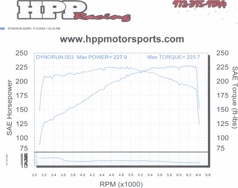

i dynoed my car at the HPP charity dyno event sat, and it put down 227/225... is that about par for what an 06 5at g should put down?

I'm trying to remember what my '04 6MT put down when it was stock ... I want to say it was around 235/225 so your numbers are about right on par.
There's a lot of variables when the dyno operator is setting up the run, they need to accurately enter the weight of the car which creates a correction factor.
Now you've got a good baseline to start doing some mods and see how much hp per dollar you can get
