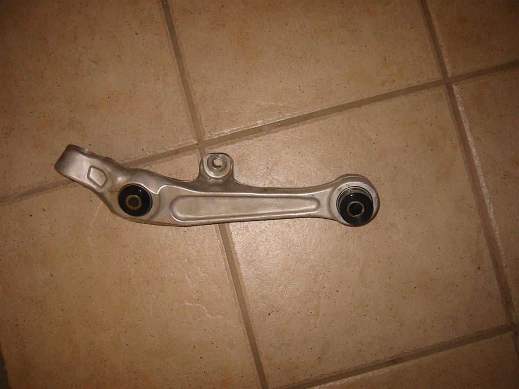

you are correct, you have to press them out. it sucks and its a tedious.. no performance but I go straight when I let go of the wheel, no clunking in the front when taking turns, your not wearing out the translink if replaced.. Whitelines are perfect replacements. IF you dont get them fixed, you can get an alignment and as soon as you leave - its off..

Replaced mine with whitelines the other day. A real pain getting the old ones out. There is a nice diy here http://my350z.com/forum/brakes-and-s...translink.html

^ Where did you buy your Whitelines?

http://www.jscspeed.com/catalog/Whit...#Bushings_5925
W52991 and W52992 for the lower control arm.

Thats awesome - I helped Jason do that DIY...my press has saved my a$$ so many times its not even funny - so worth it have one...Im looking at a band saw next...I love buying tools..

Cool, thanks for the DIY. Very clear and detailed. Gave me an excuse to go to harbor freight. The funny thing is my old bushing was so worn out the rubber was gone. I used the old metal sleeve as my "Frankenstein socket".

EPIC! fuggin great IDEA! no $$ spent on that - AWESOME man...going to have to share that one..!
