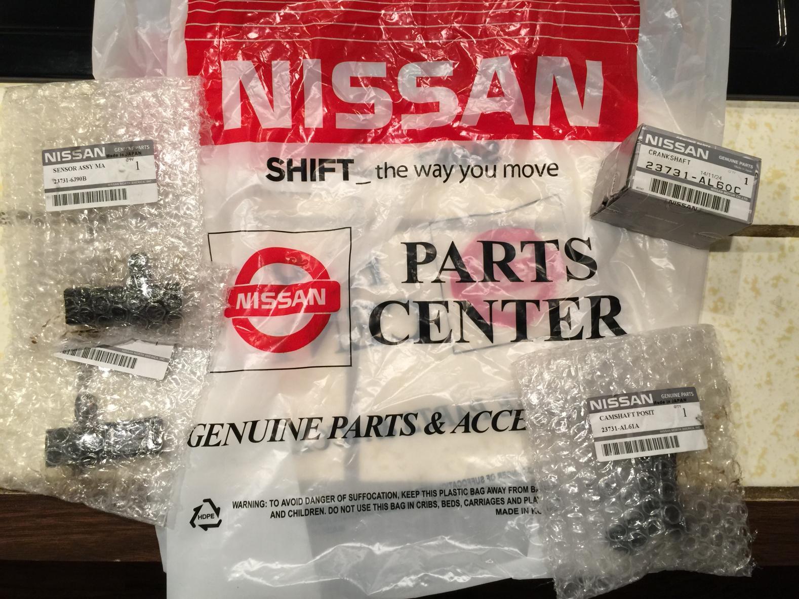

3 weeks ago I replaced the Bank 1 exhaust camshaft position sensor due to SES light and bad idle. This week the 'G' died during rush hour on Dallas North Tollway (SES lights along with Slip, Rev and VDC Light). I topped of the brake fluid since I was at the minimum line and got the code pulled. The code was P0340 - Bank 1 Intake camshaft position sensor. I have 5 sensors in total since I have a rev up engine. 4 sensors for camshaft and 1 sensor for crank shaft.
I picked up the parts from Nissan of Mckinney with my discount and had my mechanic throw them in. It sucked having to spend $540 on all 5 sensors and labor but being stranded on the road is much worse. Having to spend money on diagnostics, tow truck and paying full price at a random mechanic is not something I wanted to do. Nissan and Infiniti is notorious for faulty camshaft position sensors. I went ahead and bit the bullet on all 5 sensors at once to save on labor instead of doing them one by one every month.

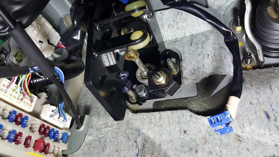

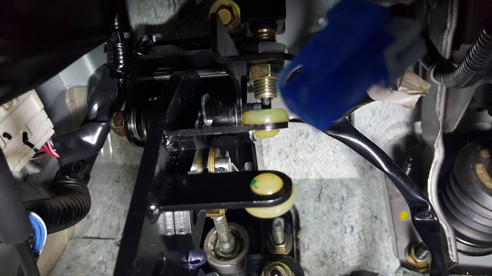

Installed the RJM Rev 4 Clutch Bracket with help from ACIDJAKE - MY350z Mod
http://www.rjmperformance.com/350z--...edal-kits.html
Benefits of the RJM AFP Pedal System
- Smoother Launches with more Control, Lower Friction Point and Predictable Engagement!
- Much Smoother 1-2 & 2-3 Upshifts Shifts
- Smoother and easier 4-3 & 3-2 Downshifts!
- Improvement in Pedal Feel & Clutch Control for all clutches OEM to Extreme Multi-plate and Heavy Puck clutches.
- Adjustable for Stroke Length, Pedal Angle/Height, Friction Point & Pedal Pressure!
- Features a Single Acting Torsion Return Spring & Eliminates the Factory "Assist Spring Mechanism".
- New Rev 4 Features increased adjustment capabilities over older versions for more setup flexibility.
- ZERO Pedal sticking to the floor after Hard Driving, Track Days or Events
- Reduces or Eliminates chance of CSC failures on 07-08 HR 350Z.
The Rev 4.0 Assemblies Have Been Completely Redesigned as Full Replacement Pedal Assemblies Allowing:
- Faster & Easier to Install than previous versions.
- Simpler Tuning Process than previous versions.
- Reduced Number of Install Steps.
- New Simpler AFP Adjustment Mechanism featuring a built in scale to see exact AFP Setup Percentage.
- Comes as a Complete Pre-Assembled Replacement Assembly, AFP comes Pre-Adjusted to reduce setup.
