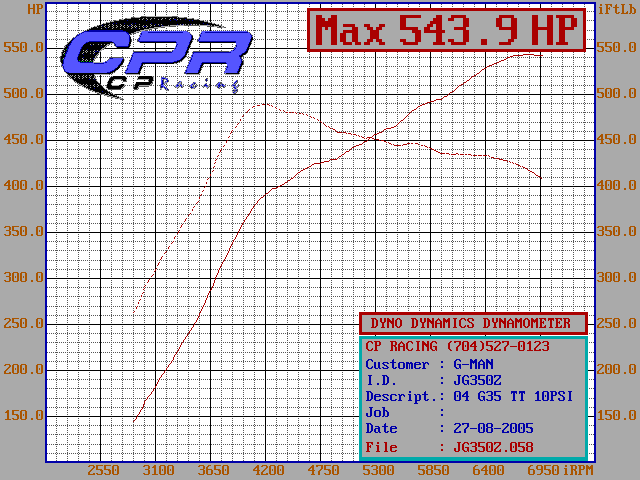

I thought I would post in this section since the car will be TX. I am looking for $43,000. The car dynoed at 543whp and 490tq at 12.5psi on 93 octane. The motor was built by SGP and tuned by CPrace and Sharif.
