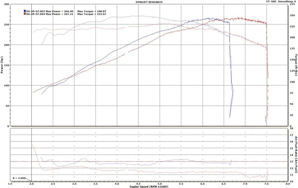

Nice runs as always Trey. I'm still really confused as to why Cheryl's car isn't going any quicker. I would have thought 13.7s@102mph for sure. It makes me wonder how C&D got 13.7@104mph out of their longterm 07 G 6MT.
Because Trey isn't used to the car and I can't drive it. He got notably better traps than I could manage all day and I can't launch for ****. I admit I'm the weak link in this one. I also haven't taken it to the track enough to get any real practice. I just don't have the time or the money to take the track trips at this point. Gas is finally coming down and our best 1/8 mile option just closed up for the season for lack of attendance. Last year they never closed. It's just down here. Maybe with some practice it will get better but right now - it's just not in the cards.
Old Oct 20, 2008 | 02:46 PM
trey.hutcheson's Avatar
Joined: Apr 2005
Posts: 3,521
From: Birmingham AL
Thanks Dave. I don't know what's up with her car. It's got a little more in it - like I said before, I've only got four runs in the thing. I'm sure I could have gotten 102mph out of it - my second run trapped 101.8.
Regardless, it's quicker than her 04. That car never trapped more than 98mph from what I recall(I could be wrong on that). Could be she just has a slower g. Who knows.
However, in comparison to my car, maybe it shouldn't be much of a surprise. I'm trapping upper 103's on my better runs, and with more runs, probably lower 102's in her car. Her car is bone stock - still on the stock air filters and tires. The only difference are the wheels - and they weigh exactly the same as the stock wheels - to within a tenth of an ounce. Plus we didn't adjust tire pressures or remove anything from the trunk.
If you recall a thread from a year ago, I plotted a dyno of her car over my car. Peak horsepower numbers were very close, but overall, my car made quite a bit more power. The only mitigating factors that I can come up with is the fact that her car has 5% shorter gearing paired with a raised redline.
Considering the different preparation for each car, my advantage in power, plus the fact that I'm able to get traction higher in the power band, a difference of 1.5mph in the traps sound about right to me.
What do you think?
** Here's the plot:

That's a great question Jeff. I hadn't considered that. The traps disprove and hunch that I'm down on power. Granted, I'm not trapping as much as I was a year ago in similar conditions, but the difference is very small.
Plus, I'm running the stock intake configuration(lower plenum, airbox). Taken as an aggregate, I'm making a tad less power than a year ago.
Who knows? At this point, the idea of my dead battery wreaking havoc on my ecu's tune seems laughable. However, it's *possible* that the ecu has adjusted itself to within some percentage of what it was before the battery died. After all, it's very difficult to disprove a negative.

wow your mid range is killer compared to hers by like 20-25hp/tq that's alot.
