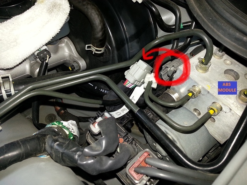

Didn't see anyone mention it, so in addition to all of the above, you should bypass or add a switch to the Yaw sensor (under the center console). just turning the VDC off won't completely disable the system so you'll still have some interference at times. There are threads around here that show how to do it (between a full bypass and adding a switch - I definitely recommend adding a switch), I haven't messed with it in a year or two so I won't add a how to that I'm not 100% sure of.
-THE easiest trick to disable VDC, ABS, etc. on a G or Z; the "vdc/abs, etc." dash lights will be on but simply reconnect the plug so these lights disappear: Anyone can avoid doing what Leksikon did (as quoted above) by actually disconnecting the grey harness/connector located on the ABS Module as seen in my attached pic "dctodrift", circled in red. The other pic "dctodrift2" is just a reference so you guys interested in doing this will have a better view of where to locate this under the hood; (U.S.A./CAN) driver's side, (EURO/JPN/OTHER) passenger's side. (I am not responsible if you crash while driving in the rain and don't know how to control your vehicle with this unplugged; mod at your own risk!!).. During inclement weather I "try" to reconnect the plug so I'm good to go; back to boring ol' stock but almost 99% of the time I it's d/ced.
