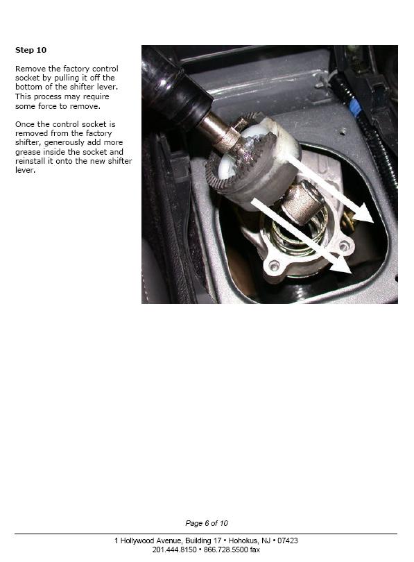

Old Feb 23, 2007 | 03:22 PM
  #29
V35 Skyline GT's Avatar
Joined: Jul 2006
Posts: 3,942
From: PNW in Washington
6MT Coupe
LOL...no confusion taken. They need to update their downloadable .pdf install file on their site then.
This is all they say about grease.
Old Feb 23, 2007 | 04:27 PM
  #30
BadBoy06's Avatar
Joined: Feb 2006
Posts: 3,442
From: Long Island, N.Y.
Attachment 64372
thats why I called. I read on the Z site alot of guys only using the
1 type. I havent been under there to see how weather/temps would effect
the shifter.
I havent been in the car in a while. Does the boot attach to the
trim piece around the shifter? Do I need to worry about breaking clips?
That pdf file only shows a Z install
