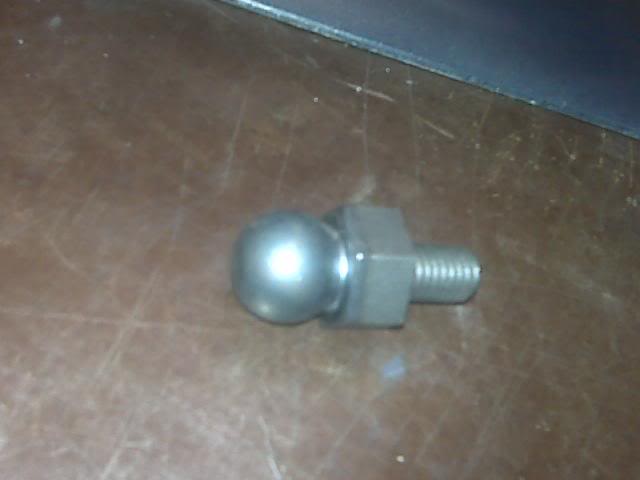

oh you mean this bolt here?
i do that bolt whenever i replace a clutch just as a saftey measure i always have one in my tool box i don't charge the customer for it. also if the tech working on the car wants to be a dick he can look at the flywheel and clutch material, if there is chunks of clutch missing from driving the car hard do you really expect them to pay for a wearable part (clutch) + the 12 dollar pivot bolt? i know i wouldn't.
also for 1300 bucks your not getting the flywheel are you? your gonna get some noise with a worn out oem flywheel and a new clutch just saying, i havn't read the whole thread though so maybe i'm missing something maybe you went aftermarket. sorry if i did miss something.
clutches are warrantied on a case to case basis becuase it is a wearable part, every case is different. just a heads up.
