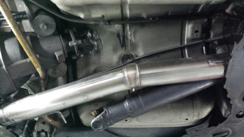

Going with SPL solid diff bushing and solid subframe bushings, here's some pics of what could happen, well happened to me
Attachment 163385
Attachment 163386
Attachment 163387
Highly recommend changing them

Holy *****
Are there any other weak points of the car being exposed @ 600rwhp? Are the transmission and differential ok after that catastrophe? and what about the driveline??? Any ideas on going with an aftermarket solution with serviceable U-Joints?
^the axles/half-shafts are the weakest part. Adding a differential brace would definitely help too. The diff and the driveshaft can handle decent power, but an aftermarket carbon-fiber driveshaft is also an option.
