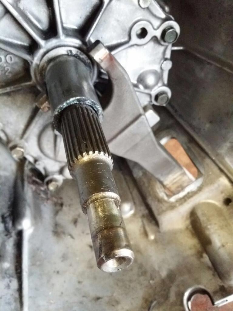

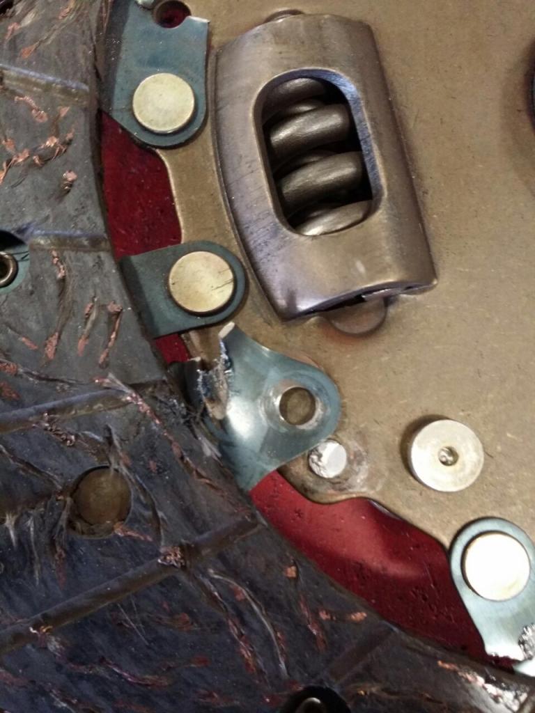

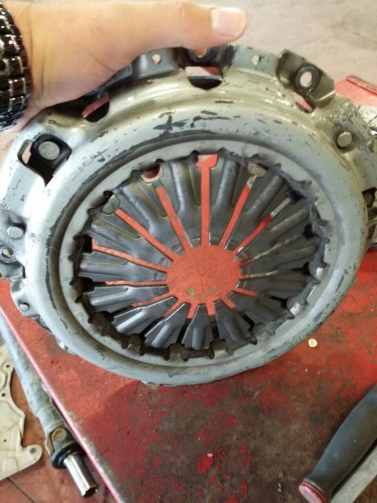

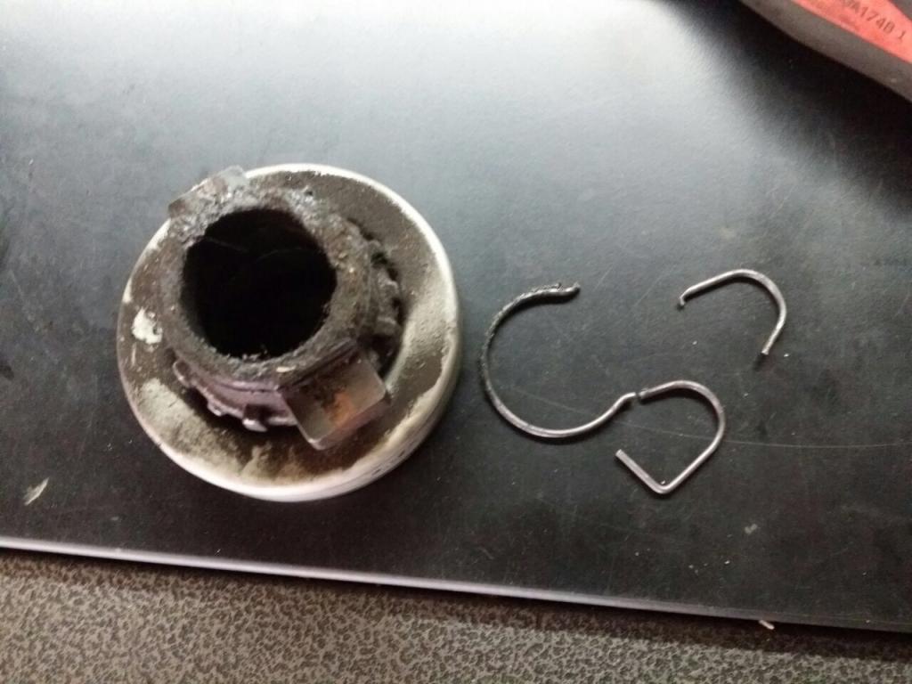

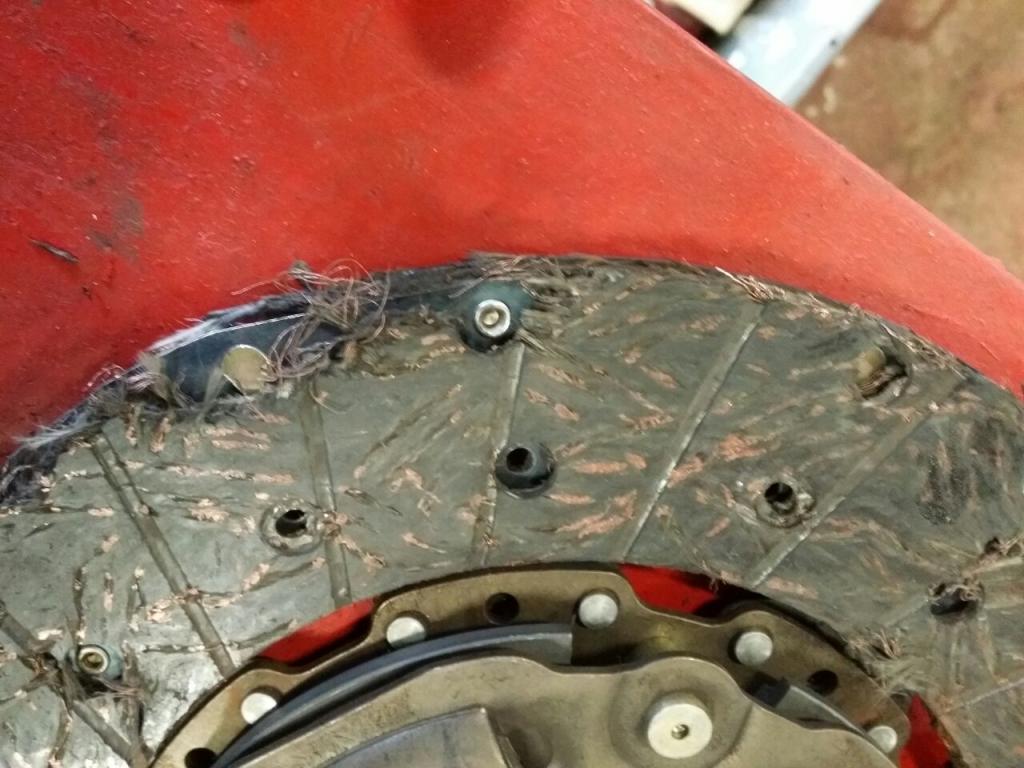

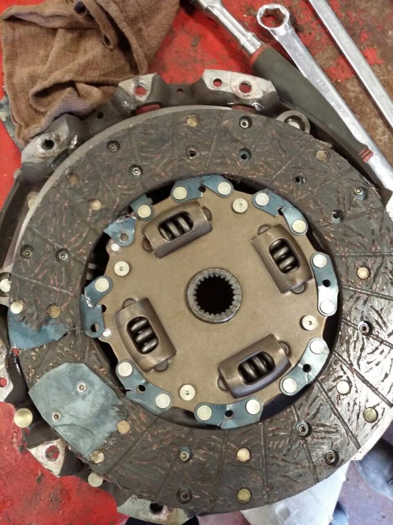

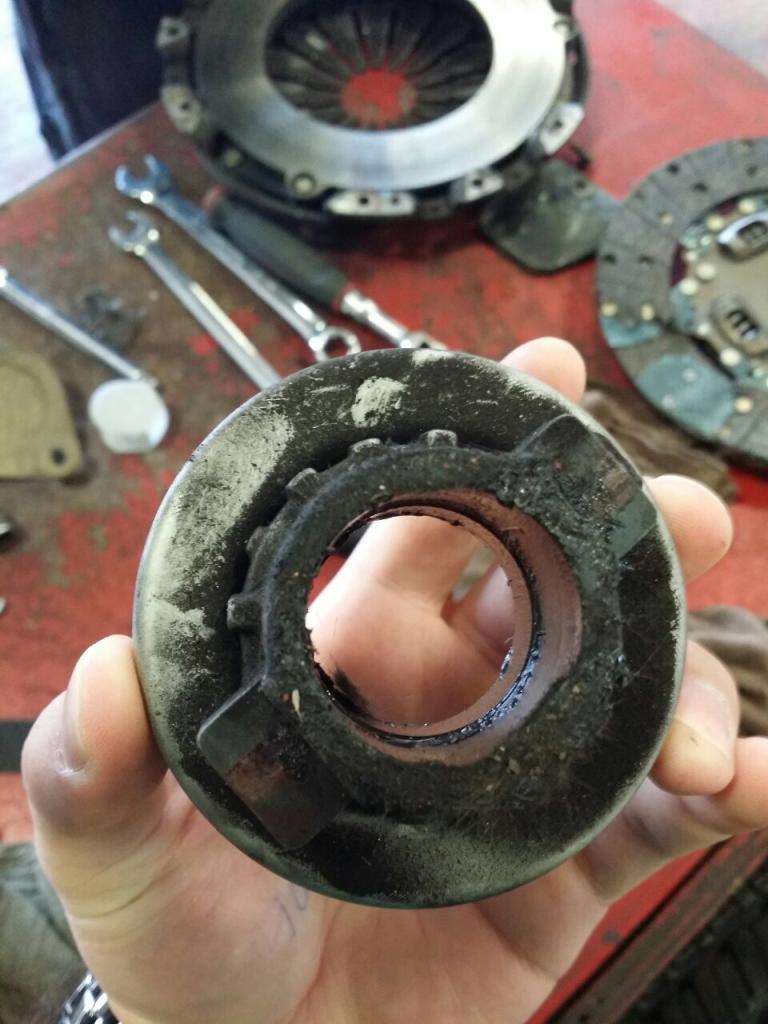

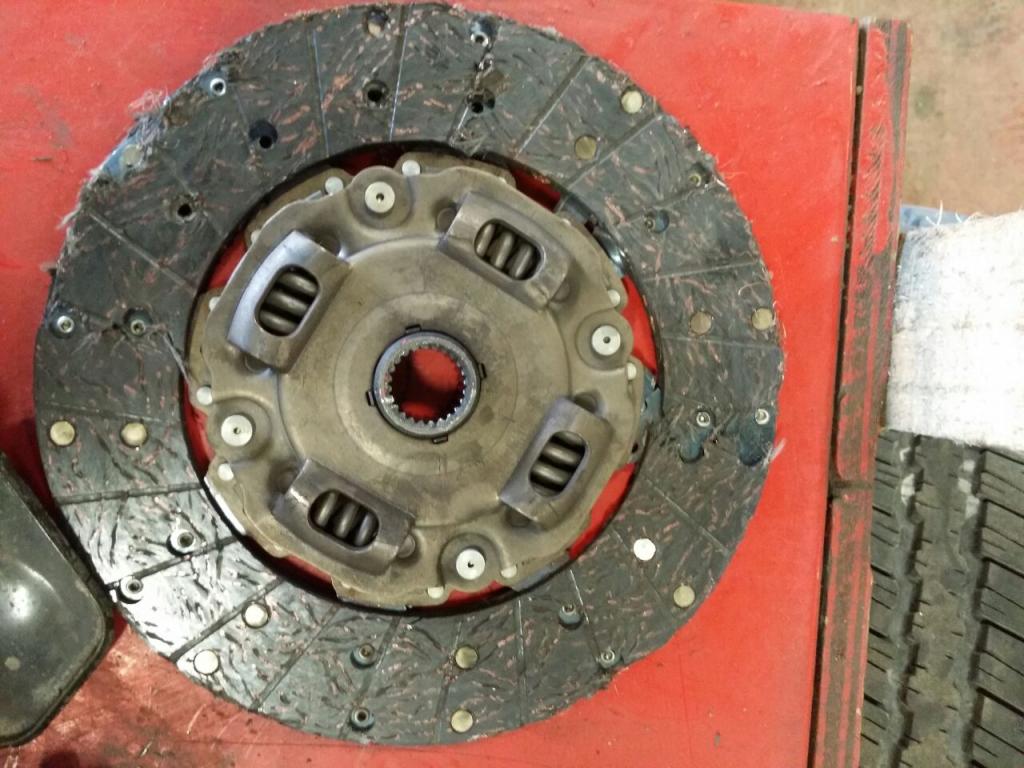

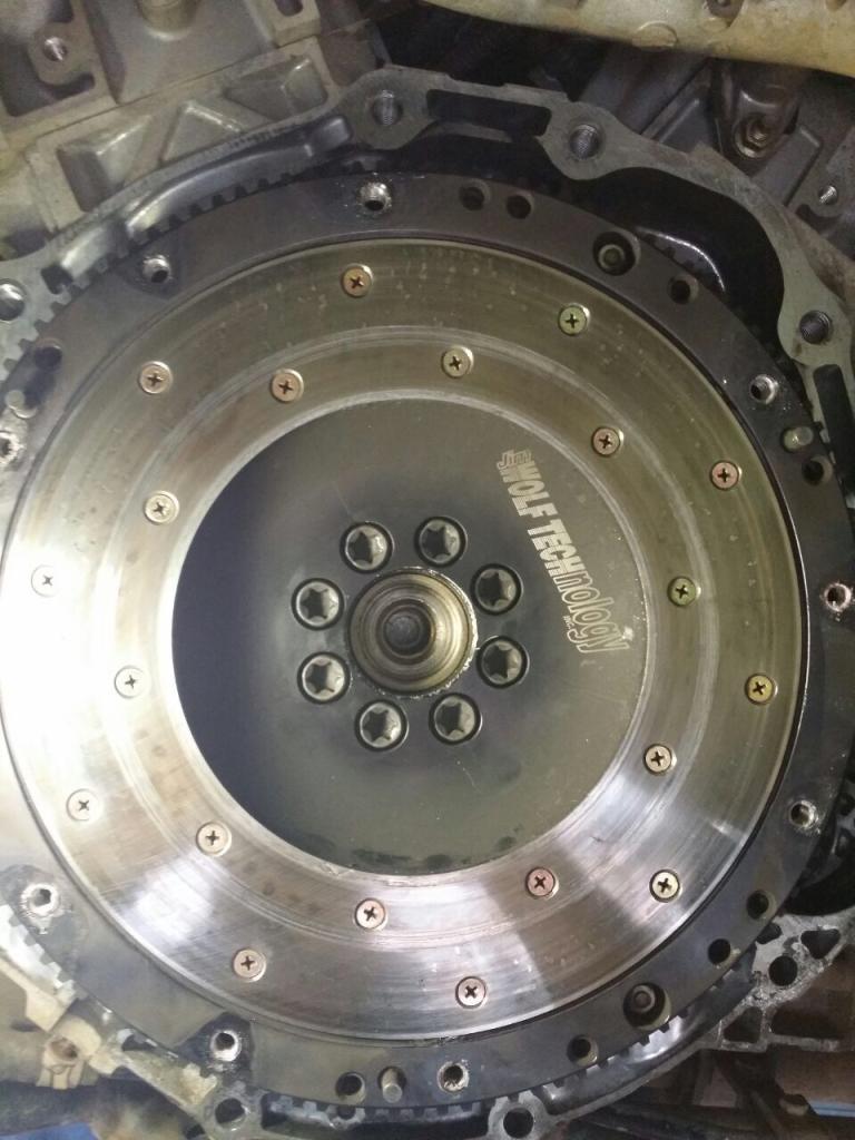

The manager & shop foreman are both away. They called the manager & she authorized them to drop the tranny. I waited there while they dropped it and noticed this.
We measured the travel of the slave cylinder with just hand pressure and it only travelled 13.8mm instead of 15.25mm which are stock specs. I'm pretty sure its gonna travel even way less with 1200kg of pressure as per JWT specs. The shop staff are convinced the damage was caused by overheat or from shifting the car previously at 6800rpm, redline is 7000rpm.
They are also very sure that there are no hydraulic issues & that everything else is working properly, even though the slave cylinder is not travelling the right distance under hand pressure. So I don't think it would even move under 1200kg.
As of right now the car is still at the shop, waiting for the manager to be back tomorrow & the shop foreman on Wednesday.
What are your thoughts on what might have happened?

Looks simply like a disk failure. Hard to say why that happened but it looks like a hard downshift or hard launch may have caused the linings to come off the facing or it simply could have been a bad clutch facing.
