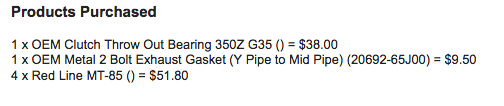

Ok I see what you mean... I've never seen the bearing loose on the carrier sleeve like that before honestly, my gut instinct is they shipped you the WRONG or a DEFECTIVE bearing.
What does the number on the bag it came in say, I think the correct Nissan/Infiniti part number is 3050269F10, is that your existing bearing carrier sleeve?
i got it from Z1 motorsports.... i called them they said it was fine to put it on.
Im not sure what to do at this point, seems sketchy.

Something definitely sounds wrong, if you start rotating the bearing ON the carrier sleeve then it's going to create a lot of heat. If it's the same bearing carrier sleeve and you pressed the old one off then I'd say you ended up with a defective bearing. If it's a DIFFERENT carrier sleeve and you never saw a bearing attached to it then I'd say the fault is likely the sleeve. Just to verify the packaging was for an OEM throw out bearing yes and it had the proper ID number I listed earlier, the package was unopened?

Just for the sake of checking, exactly what markings are stamped on the bearing? It's not a Koyo RTC40SA3 is it?
The bearing that I took off it was a g35/350z bearing .it wasn't spinning on the sleeve at all .when I took off the old throwout bearing .
The z1 bearing that's spinning on the sleeve. Its a koyo RCT4000SA. That's the one I got from z1

That's the correct bearing. I guess your bearing carrier sleeve is damaged, it's possible the old bearing was seized and spun on the carrier and wore it down considerably or maybe it was defective in the first place.
I'm surprised Z1 said it's ok to install like that, did you email them the video link so they could looks at it?
