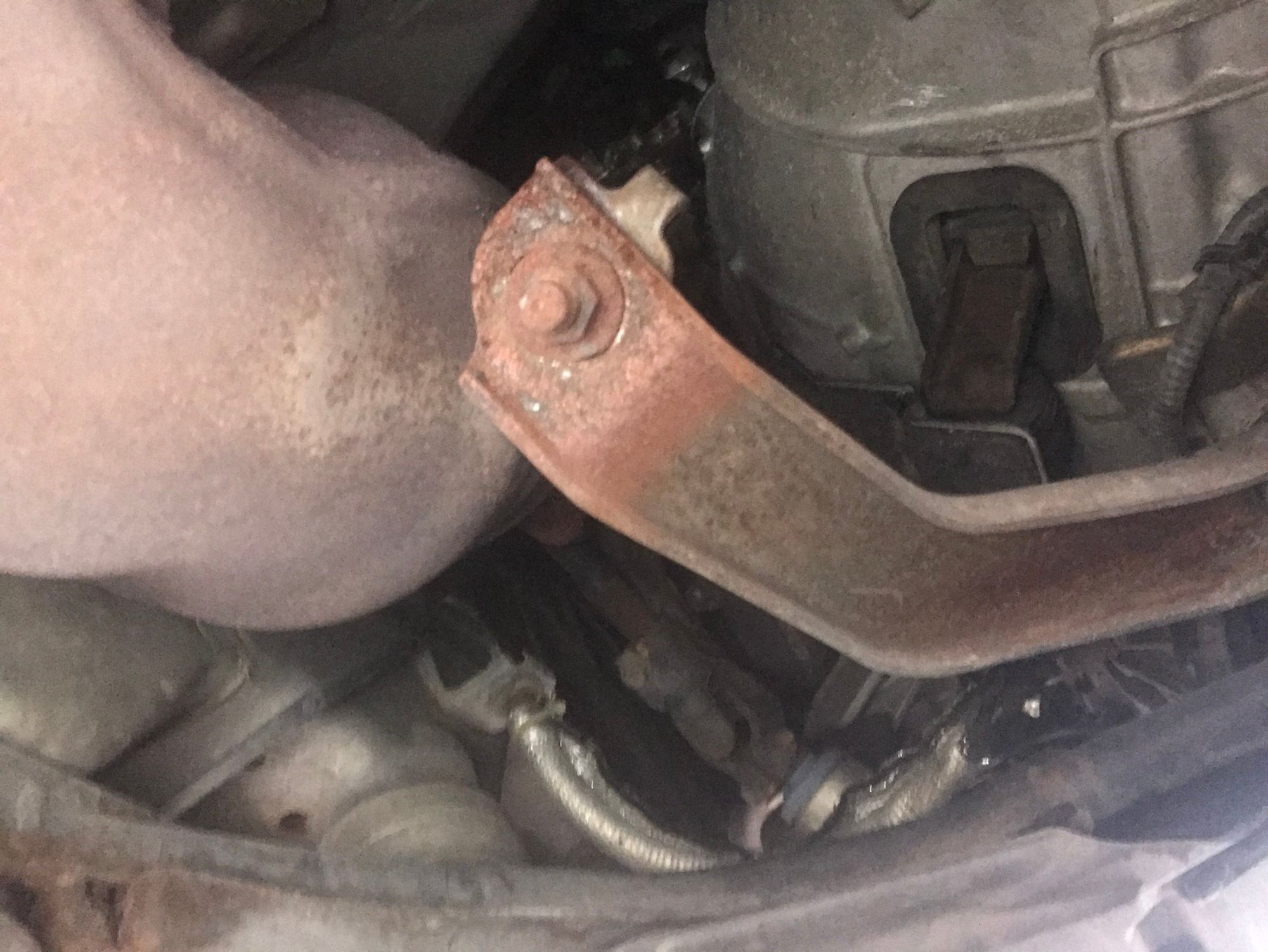

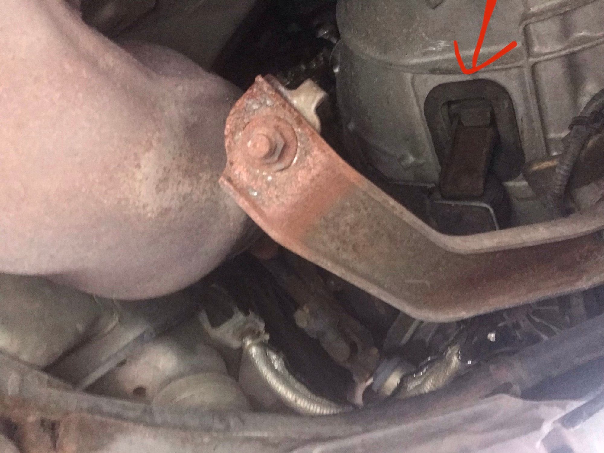

Issue Resolved - OEM Throwout Bearing
So Friday I went to my mechanic and we put the old gal up on the lift while she was running, @telcoman you were correct in pinpointing the noise as the TO bearing.
Fortunately, it just got a little dry on the shaft and that was causing that annoying noise, we were able to peel back that little rubber grommet/cover where it meets up, and get some premium lubricant inside (while the vehicle was off) I worked the clutch a few times and also depressed it while he lubed it up one last time. This instantly did the trick, and my cluch pedal feels a lot better now too, it returns a lot smoother after being depressed.
I’m unsure how it got dried out after only 6K miles, but I do realize he could only lube it once before putting everything back together.
I can say with certainty though that the issue is resolved and the noise is gone. I just took the G almost 1,000 miles yesterday from PA-Florida and she did excellent. I’ll update in a week when I get back that it’s gone for sure.
Picture of the rubber piece on transmission housing to pull back & Access bearing. We used Westland lube with one of the long thin plastic hoses to access it (kind of like what comes on a can of WD-40 but longer)

Unfortunately this is what happens sometimes when you take your vehicle to a private mechanic instead of a reputable authorized Nissan service shop. It's one of those "you get what you pay for" kind of things and why reputable authorized shops typically charge more, they do the job right the first time.
He didn't follow the steps in the FSM, there are multiple grease points that probably never got lubricated. I strongly suspect you will have to do this again probably every 10k miles or less. You're supposed to lube all these points with a lithium based grease. I doubt an aerosol can will be able to get enough grease into these spots but it's a good band-aid.
Here is the picture from the factory service manual of all the grease points.
