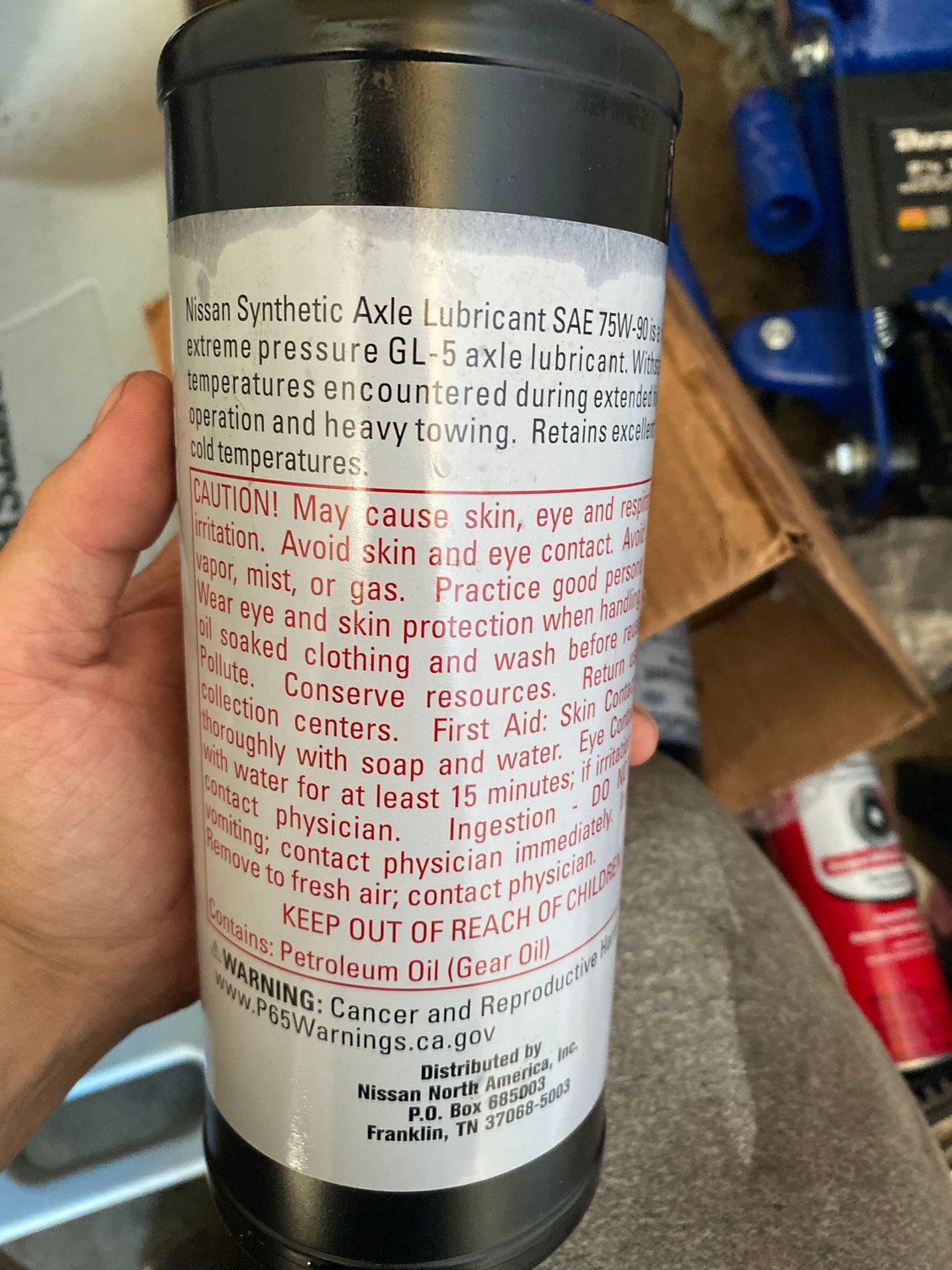

I read online not to use GL5 fluid in the cd009 as it will cause damage to synchros. I bought the 75-90 and the bottle says it is gl5. Was the article right in not using this?

You sure it isn't dual rated GL4/GL5 ? Sorry I should have mentioned but yeah if it's only listed as GL5 then that would be the oil for your differential, GL4 goes in the manual transmission.
Most of your modern stuff is dual rated though.

Only thing I noticed was gl5 on the bottle. I put it in my transmission. But I got the entire swap done with new exhaust and I’m having a no crank no start. It’s acting weird asl, every time I turn the ignition on my blinker starts flashing, some interior lights and dome light flash as well, cluster doesn’t light up. Tomorrow I’m gonna try to jump the battery but I’m guessing it won’t help.

I greased them up with all purpose grease by valvoline (I think). The noise isn’t super present but it’s there. If I get the car running tonight I will get the sound clip. What u think about that bottle of 75-90 that says gl5?
