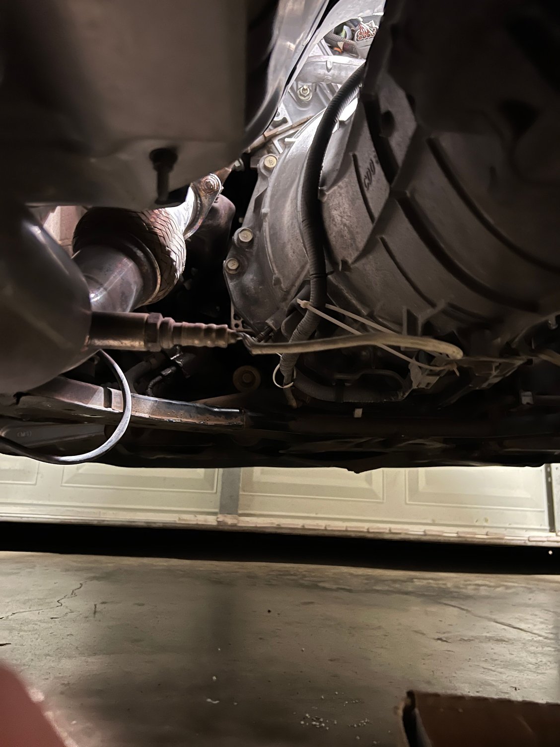

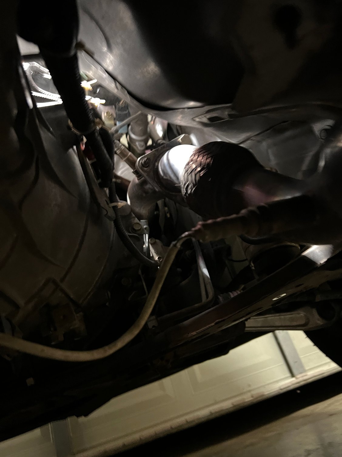

Old Oct 1, 2022 | 12:41 AM
FrankenG's Avatar
5 Year Member
Joined: Feb 2018
Posts: 47
From: North Texas
AT-MT swap Coupe
@cleric670 Can I get away with leaving my res test pipes on? Maybe just remove the O2 sensors? Looks like it’ll clear to me, but I had my oem cats last time I did this
Old Oct 1, 2022 | 09:54 AM
cleric670's Avatar
BANNED!!!
Joined: May 2017
Posts: 14,837
Likes: 2,497
From: Washington State
Coupe 6MT Premium RAS
Technically yes you should be able to leave them on but I always take them off since it's only a couple more bolts. I always start the bellhousing bolts by hand though (like literally with my hand) and it's a really tight squeeze for me to get my arm up to those ones on the top with the cats/tp in place.
