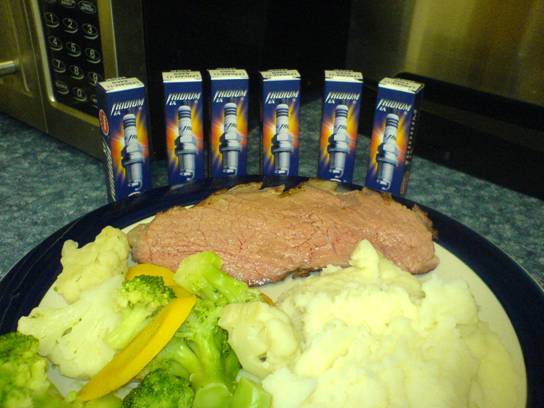

This is my first post. I read the original post to help me with my spark plug change at 90K. I modified the installation procedures as follows:
Pre-installation: check outside temp (30 degrees F) at 10am. Prep smoker, dry rub rib roast, place in smoker. Put turkey bones in pressure cooker with noodles, pressurize and cook 15 minutes, let naturally depressurize, put in vegetables, pressurize, turn off heat and let depressurize. Sample turkey noodle soup. Check outside temp (36F) at 12:30pm; decide to begin installation.
Installation: Remove Injen shorty intake, pop off throttle body and clean (it was pretty dirty). Take out spark plug #6. Notice gap appeared large. Go in the house and take out gap gauge and notice gap is 0.075 (all subsequent plugs were around this gap). Eat more turkey noodle soup. Install #6, and do #4 and #2. Reinstall all parts and nuts and bolts on driver side. Move onto passenger side and do all spark plugs on this side. One hint to get #5 coil out, put 10mm on extension and put on harness bolt and leverage wires out of the way. I was having some problems with #3 and #1 until I snapped off the plastic piece routing wires around these two plugs. Install plugs and reinstall all hoses, nuts and bolts. In between each plug I made sure to check rib roast, and at one point I placed remaining soup in the refrigerator. I also did not detach the wiring to the coil as there was enough play in the wiring.
Post-installation: Took car for test drive and appeared to run fine. Decided to floor it on a freeway on ramp , had to brake hard before I reached the freeway, because I was already up to 80mph. Get home and before shut down notice my car is now idling at about 825rpms. I guess I'll need to figure out how to bring that down to the 650+/- stock. Take rib roast out of smoker (140F) nice and rare. Let roast sit, and prep fixings. Eat a nice meal.
DIY: Spark plug change-ribroastandsparkplugs.jpg
So anyway, has anyone else noticed that their old spark plugs have such a large gap? It seems as if the point burned down. I'm somewhat surprised the car was still running as well as it was (30 light-footed mpg).
