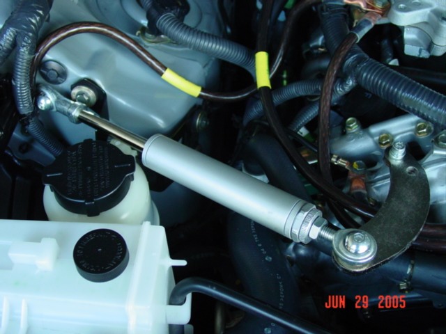

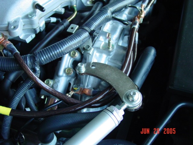

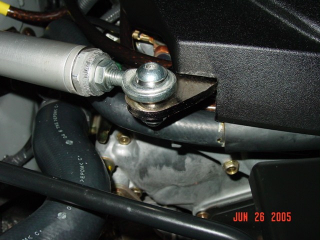

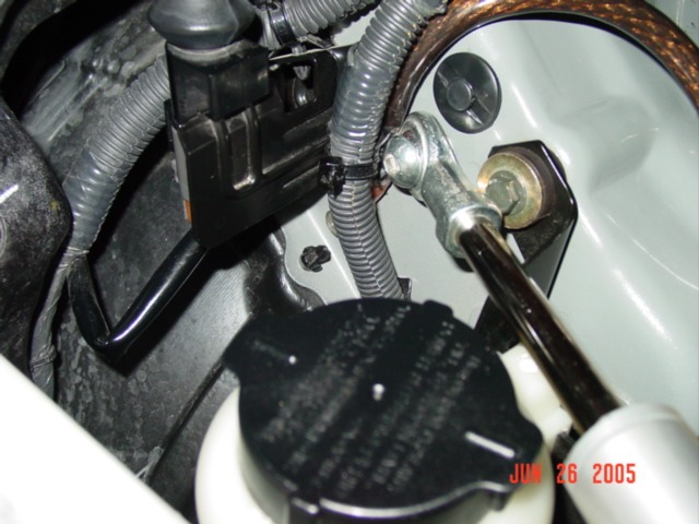

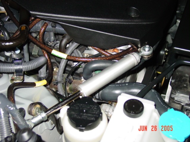

Here is a few pictures of the Pro-1 installed on my G. One end attaches to the engine with a curved mounting bracket and the other end to the hood bracket. The function of the damper is to limit engine movement during high torque events. IMO, the hood sensor bracket is too flimsy and would flex (the hood sensor bracket will move when I push on it). So I found a solid location, drilling a hole in the fender. I had to modify the engine cover with a little cutout to compensate for the new mounting location. I ran the damper for a few months, but unfortunately there is clearance between the bolt and the swivel joint (the last picture shows the bolt and swivel joint) creating a rattle loud enough to bug me, so I removed the damper.
