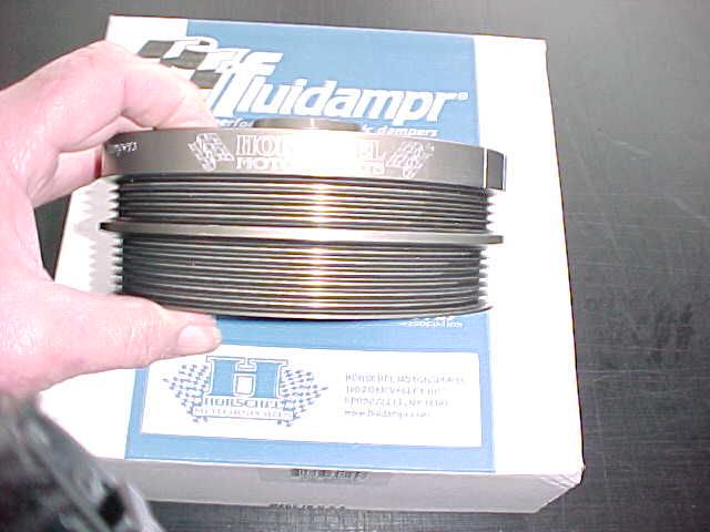

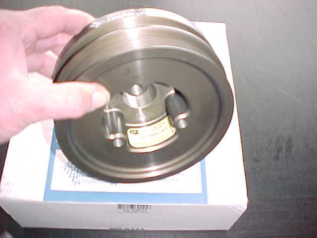

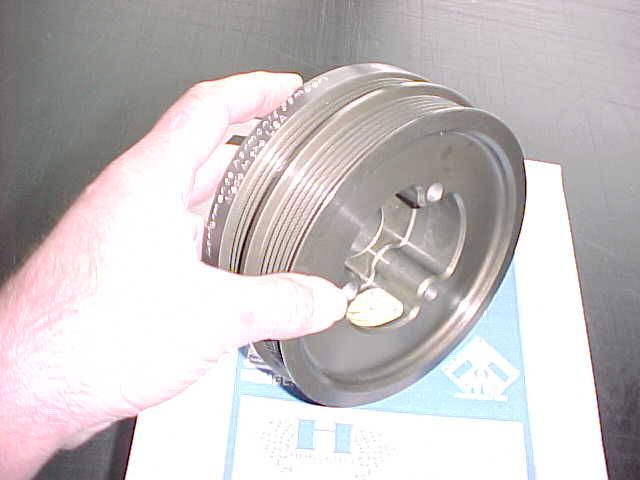

Here is a few pictures, When I have time I will explain more.
Attached Thumbnails UR Pulley Update: Check In Please-p1.jpg   UR Pulley Update: Check In Please-p2.jpg   UR Pulley Update: Check In Please-p3.jpg

Originally Posted by GEE PASTA
I will do a post on this when the time is right. Understand that most mods do not show much or any gains on the VQ. Headers would be the best item that just plain doesn't show power. The cam timing is the ticket here. do you realize that nobody even knows the cam spec's on a rev-up engine.
Well ,I do. The design (stock),,,,,is just for smog. There is power in the VQ stock you just need to find it. I will need to dyno at Churches in Calif.
for a real HP figure. The first dyno there was 273 HP 264 TQ. I know, The engine is way stronger now. PS cam change is a lot of work.
