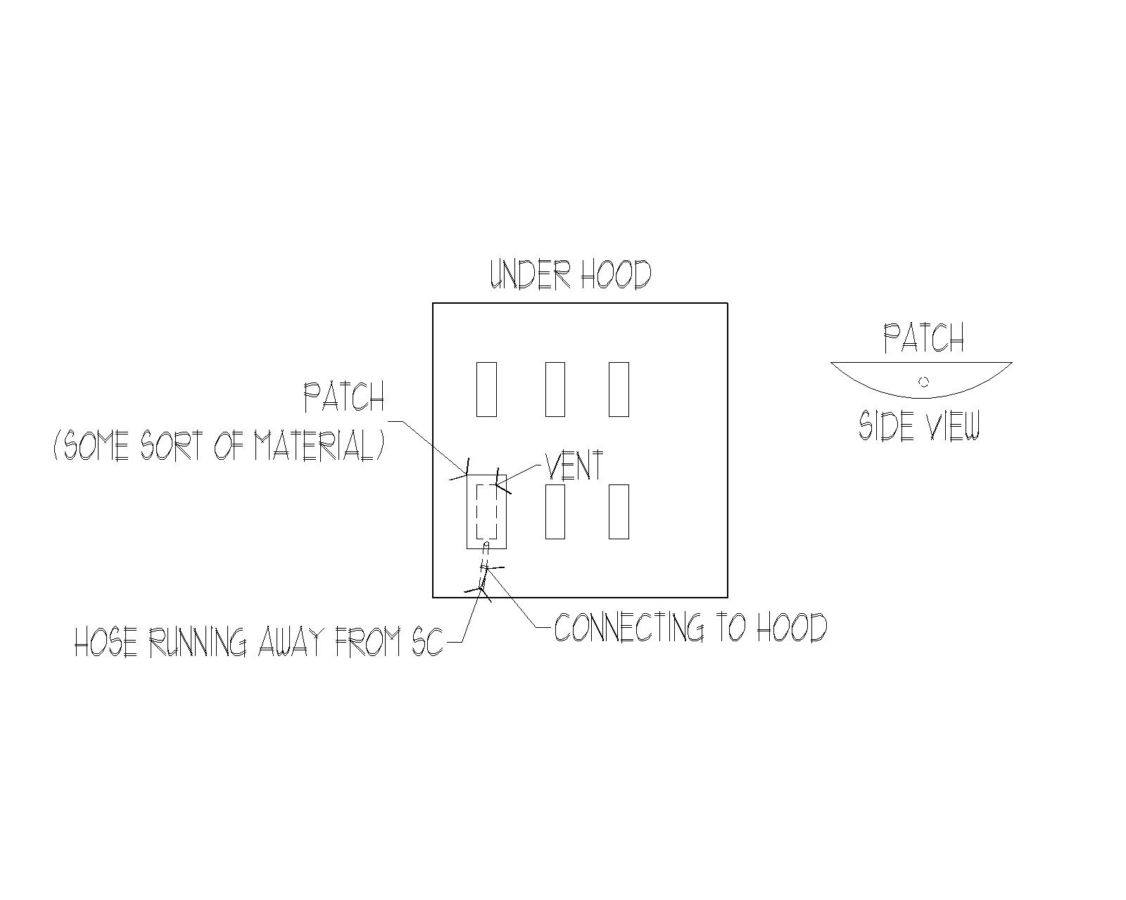

If you really need to keep water off of it, maybe you can fabricate something small enough to patch the vent w/ maybe a small hose (windsheild washer hose..etc.) connected to the patch & vent and would just drain whatever water would collect to the side.

Here is what could possibly be done, i need to think of something to with the vortech sc being installed later.

Click it, if its blurry make it bigger. If you still cant see it try to save it.

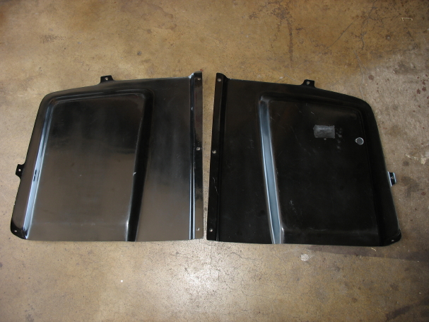

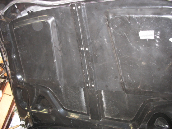

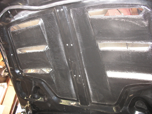

Then vents are over the filter and charger.What people don't realize is that your car may be sitting around parked while it is raining.Yes the filter will get saturated with water.When you wash the car water will run right to the filter and charger as well.Sure when you drive,not much water will get in,but what does will make a mess,especially when it hits those moving belts.The covers on a authentic TS hood do hit the super charger.I had to modify mine a little to clear.But the vent cutouts on a TS hood are a little deeper than a Seibon hood.Also people say don't worry because of the holes in the grille,Well the radiator blocks water from getting to the engine.Here are a few pics,don't mind the dirty underside,it is usually not dirty.
Attached Thumbnails TS hood + Rain Guards-img_0972_1_1_1.jpg   TS hood + Rain Guards-img_0973_1_2_1.jpg   TS hood + Rain Guards-img_0974_1_2_1.jpg

rsinghud, can you post pics of the underside of your ts style hood? a pic like caskyline's first pic would be great. thanks.
