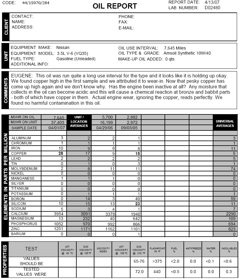

Ok, here is my result after using Mobile1 0W40 for 2500miles. I have a Single Turbo running 8psi around 360whp on my Stock Motor. This 2500 miles are all hard driven and lots of WOT Pull since I was adjusting my A/F for the Winter Driving. I only drive my car on the Weekend so I go WOT every chance I get My oil was almost black when I changed them so I was surprise that it did hold pretty good. My car is pretty much stock except the Turbo and Mrev+. I think I can still push a few more hundred miles but I'm happy to change my oil at 2.5K miles

Here are the UOAs I have so far from my 05 Sedan
I'll be doing another one in a few months...

I really have no idea how to read those charts...i do literally, but i don't know what the numbers mean? Could someone explain to me what the numbers mean???
-Sean
Old Jan 10, 2008 | 06:55 PM
  #30
bythabay's Avatar
Posts: 2,174
Likes: 77
From: Santa Clara, CA
-Sean
see the attached image for an explanation
