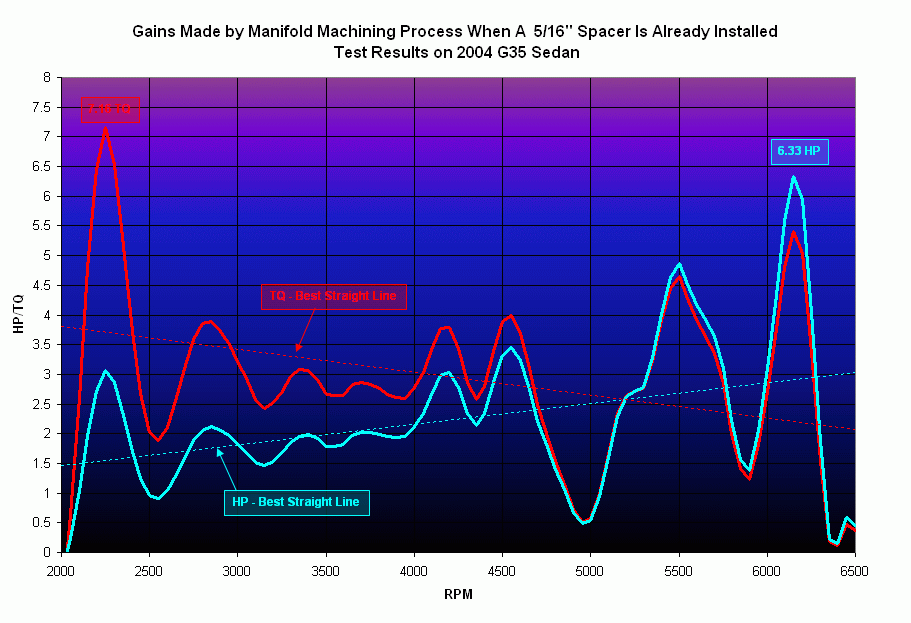

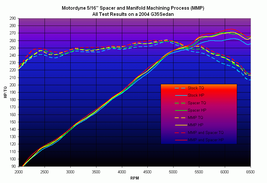

The MREV2 was tested on a nonrevup 04 G35 Sedan a while back.
It was initially called MMP before it was named MREV2.
You can see the NONREVUP dyno plots below both with and without a spacer.
Attached Thumbnails REVUP or non REVUP that is the question-april-31-plot-1.gif   REVUP or non REVUP that is the question-april-31-plot-5.gif

Yah I've seen your dyno graphs on your site, i can really feel the difference, especially with our uber winters up here lol. I was just puzzled as to why people are saying that the MREV2 isn't benificiary on the non revups. . .
