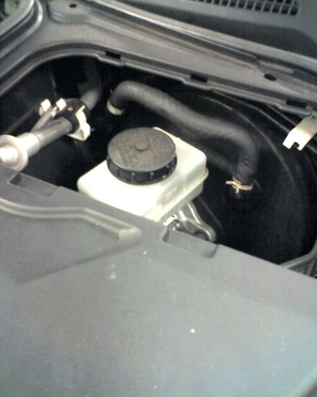

which line is the brake booster line? pix plz
Old Dec 19, 2010 | 05:30 PM
TIAN's Avatar
Hold The Line
iTrader: (20)
Posts: 17,779
Likes: 622
From: SFL
It's the thick rubber hose. It's coming from the intake manifold to the brake booster. In the pic its the hose right above the brake fluid reservoir.
