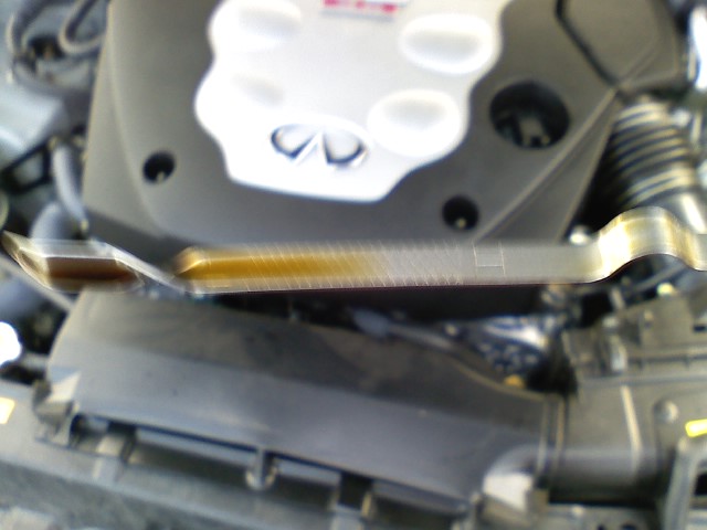

My car burns oil, no doubt about it. As far as the cross stitch area on the dipstick, I averaged personally, that it burns 1/4th of the oil on the cross stitch area every 1000 miles. How many quarts is that? (mm?) I brought her in, asked for the test, then they topped and taped off everything and I came back in 1000 miles, which turned out to be more like 1250 miles.
They said I only burn 1/3rd of a quart every 1000 miles... is that true?? Every time I get an oil change it goes from light tan oil at H to dark black oil at L.
I have a pic of where the oil was when I got back to my car, after they said I only burn 1/3rd oil...I'm annoyed that my car is burning any oil at all.
Let me know if they are full of it or not, thanks, I appreciate it.

If the cross stitch area is equal to a quart, then thats about right. They said 1/3rd, I said 1/4th.
Even though I'd rather it be at ZERO!
That ruling about 1 quart every 1000 miles is ok, is completely bull ****. I mean filling your engine with a quart every 1000 miles?! WOW. I think anything more than a half quart of oil burned in 3000 miles deserves a new engine. Or, before that even happens, better engineers to design the engine.

I just got my engine block replaced for the same issue. Within 1300 miles of the oil comsumption test, the dip stick was about 10mm below the H level which is clearly a FAIL. I've been about 200 miles into the new block so we'll see how this new block performs.

My oil went down between H and L just as much as yours did in that pic but my car did that in about 380-400 miles.. Nissan said I was consuming a lot.

An engine burning a little oil (ie a quart every 3K miles) is considered very normal. Burning a 1/3 QT every 1250 miles is nothing to be concerned about, but you should monitor it.

Based on your tag that this is an 07 sort of bothers me depending on the mileage. On an old car it was often stated that you actually wanted to see some oil use since that was an indication that oil was reaching the areas that needed to be lubricated. On a new car that is driven normally there really is no excuse. The less oil in your system the more concentrated anything that ends up suspended in it tend to become.
So far with my 08 every oil change has looked like it was pretty much just put in. Just enough color to make reading the dipstick easier.
I would document this very carefully, maybe going as far as measuring all the oil that is drained after an oil change and exactly how much is used to replace it so you can have a running record of just how much it consumes. Later on when you may need to make a claim you may be able to show a trend on how that consumption progresses.
If you are burning 1/3 quart or so per 1000 miles I would call that excessive for a newer car but then the one making that decision if push comes to shove probably would state otherwise.
If you have to pass emission checks keep in mind that excessive oil use will influence various test results so you may have another avenue in that direction.
