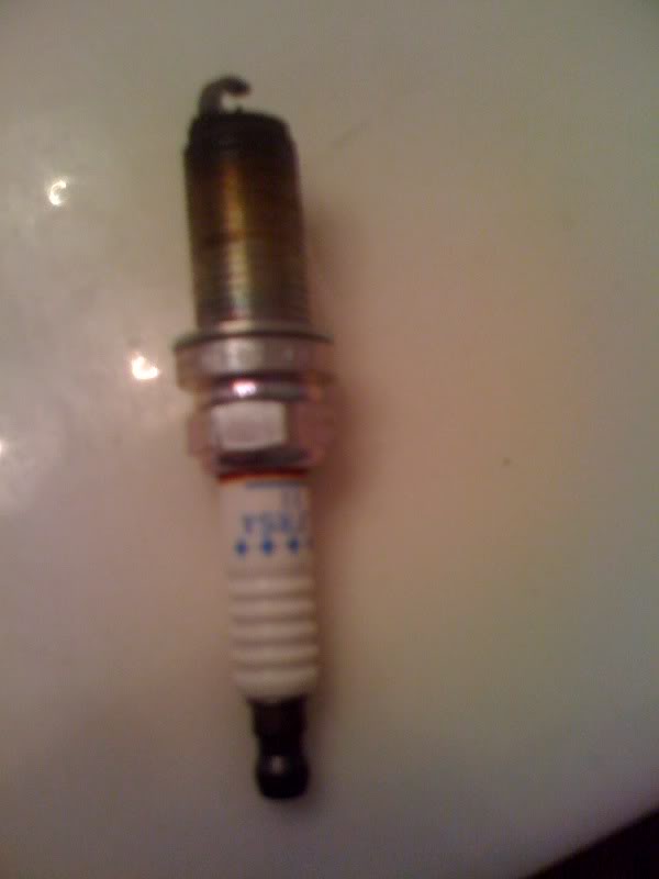

im running ngk iridiums at stock temp, you should be fine unless you have a fair amount of modding done. this was what my stock plugs looked like at about 52k
i think the the burning on the insulator was from the advance im running. the iridiums have cured my misfires and the engine revs much smoother now

pull your plugs and take a look at them. burnt insulators are a sign that you need to upgrade your plugs
