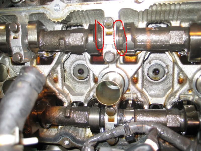

I pulled off the valve cover. I snapped a few pics. But theres a few spots that don't seem right. It looks a bit scratched up. I circled them in the pics.

any suggestions?

Your valves need to be adjusted. My friend just had the same problem after he just built his motor (cams, pistons etc). First it started off with a small tick and then it just got louder and louder. He finally checked it out and found out that his valves were not set to spec causing the valve to hit the cam He had deep scratches on one of the cams and a valve fell out of the head.
