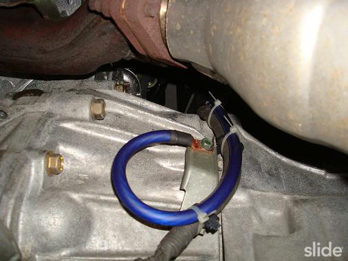

So I was doing some maintenance on the car and I thought it would be a good time to get the transmission grounding wire on. I have one from Sean (SxExCx) on here and located the suggested grounding point. The only problem is, there is the front driveshaft right there. There is literally about a 3/4" space between the transmission case and the driveshaft and the bolt is about 3 inches up.
For those that have installed this, any advice or suggestions would be appreciated.

i put mine to this point

that looks like it is right in front of the black tranny pan?

i put mine here, but i don't think its grounding anything there as there was no difference in the shifting on the A/T at all. davidxu, did you notice a difference when you put the wire there?

Old Apr 18, 2010 | 11:26 PM
davidxu's Avatar
Joined: Sep 2009
Posts: 1,511
Likes: 15
From: Waterloo, ON
a slight bit. Not day and night difference though..
Just mount it anywhere on the tranny housing but away from heat components or moving parts.
do an ecu reset after.
if i shift while WOT and i shift at 6500rpm, it used to shift at 7000RPM or over. Now it shifts at around 6800RPM

Is that on the driver side of the tranny?

yes i believe mine was in the drivers side of the trans but it was a while ago. . .i remember it was hard to get at

My picture is on the pass side.

yeah, figured with the driveshaft right there

Still havent found a good spot to put the AT grounding wire. Any other suggestions
