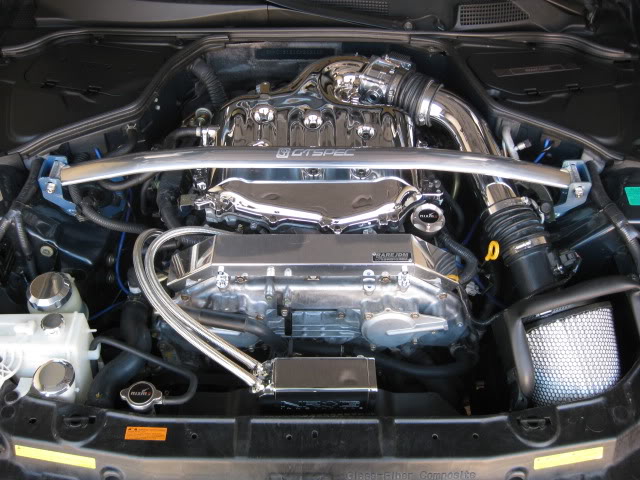

NRG and Greddy are both excellent choices. I have the NRG but did have to replace the cheap hoses that came with the can. Braided vacuum lines are a very capable replacement.

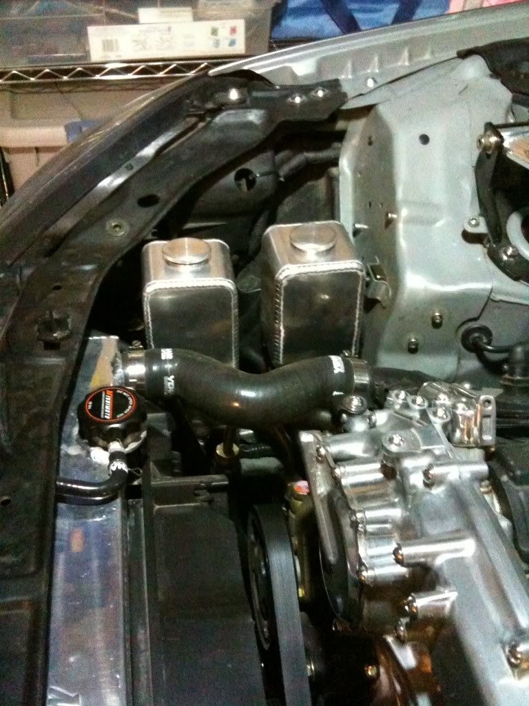

I bought a Weapon-R power steering tank a couple years ago and the welds busted after 2 days.
This is the reason I started making my own tanks:

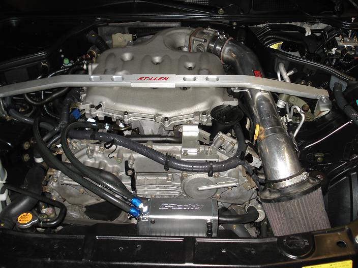

I went with the Greddy. Pretty much identical set up as Blue Dream's.
I've had not issues or complaints thus far.
Which look great and very well made BTW!!
