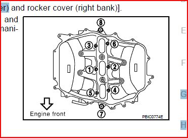

Old May 15, 2010 | 07:32 AM
LMG_35C's Avatar
Posts: 350
From: New Jersey
I count eight bolts in the lower plenum to be removed. There was absolutely no issue when I replaced mine.

Old May 16, 2010 | 03:29 PM
Blue Dream's Avatar
I drove ttrank's car solo
iTrader: (50)
Posts: 18,299
Likes: 1,488
From: By the sea, Tx
You're right. I think I had a brain fart.
