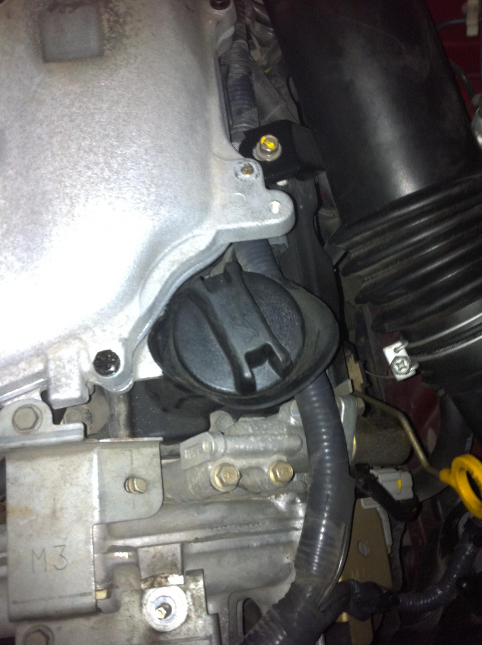

Thanks fastgkid. We fixed the problem. The rubber piece under the oil cap was trapped inbetween the gasket and the cover. So you were correct! air leak! Heres a pic for people if they stumble upon the same problem
Notice: Pic is after problem was fixed. Rubber piece is tucked under to simulate what it looks like.
