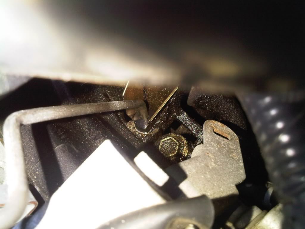

I don't know i put like 20k on it with the oil leaking a little nothing major and i never had to add anything but it does need to be replaced that i know for sure. i have read the Covers its elfs aren't great and tend to crack over time stupid design.
Here is a pic, its the whole side like that and no it's not leaking from the oil dip stick.
Mines looks just like that just less oil cuz it just started ! But yes that's the same problem. I need to get this fixed asap don't like the smell, neither does the ladies lol
