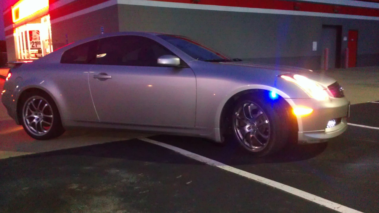

Hi every one I am a recent 05 G35 owner . I joined the site a few months back when I bought my car. So far I have had a great both driving and installing mods. But in the process of pushing the car for more and more it has come to light that there are several internal engine issues valves seals being one and worn rings being he other.
The car has 135k and was neglected and or abused. I drive it hard and although I do not trck it it stay above 5 grand when I have it out most every week end.. I intend to build a forced induction motor either for it or a second but until then, I am interested in seeing what can be squeezed out of this motor while still keeping it a weekly if not daily driver. I do my best to maintain it meticulously and as I now face a rebuild I am hope those of you with expertise and experience may guild me into areas where money is best spent.
Currently I have installed a 3" cold air intake with induction cowl fabricated in bumper lower grill. I have a motodyne 5/16 plenum spacer and megan Racing test pipes (I Iive where there is no emissions inspection) I need a remap eventually for the the amount of air but it is doing well with it running like a scalded dog..
I will be fitting it with borlas when done with engine and be seeking suspension advise should I go coil over and camber kits or performance shocks and poly bushing kits. But first the motor, Any help is greatly appreciated . Heads, cams, springs lifters, pistons , rings , injectors. I've got about 2500 to spend on parts over and above machine work and will do most of the labor myself again thanks for all the help so far.
Attached Thumbnails Engine Rebuild advise-phone-may-oct2013-325.jpg   Engine Rebuild advise-phone-may-oct2013-038.jpg
