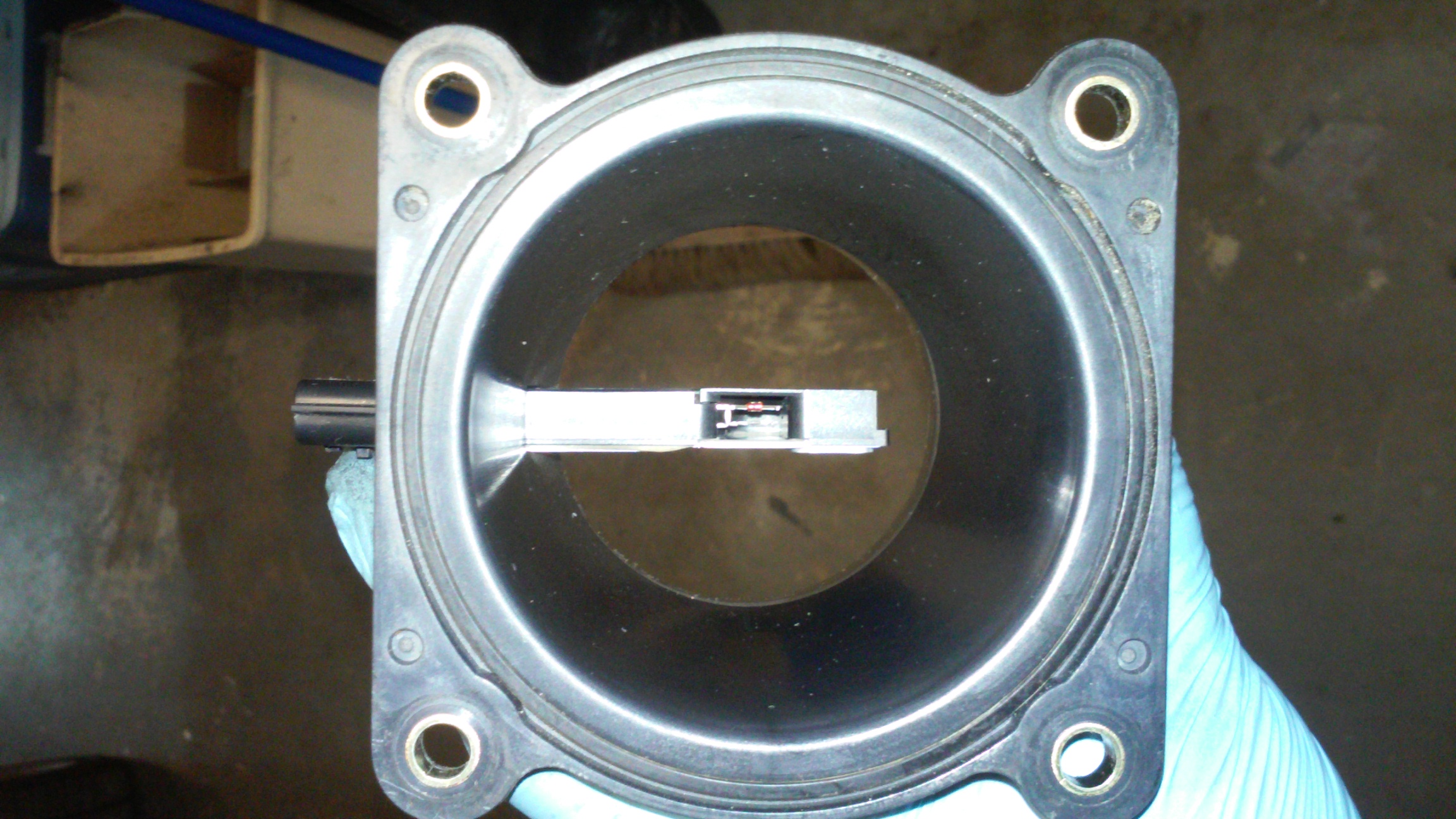

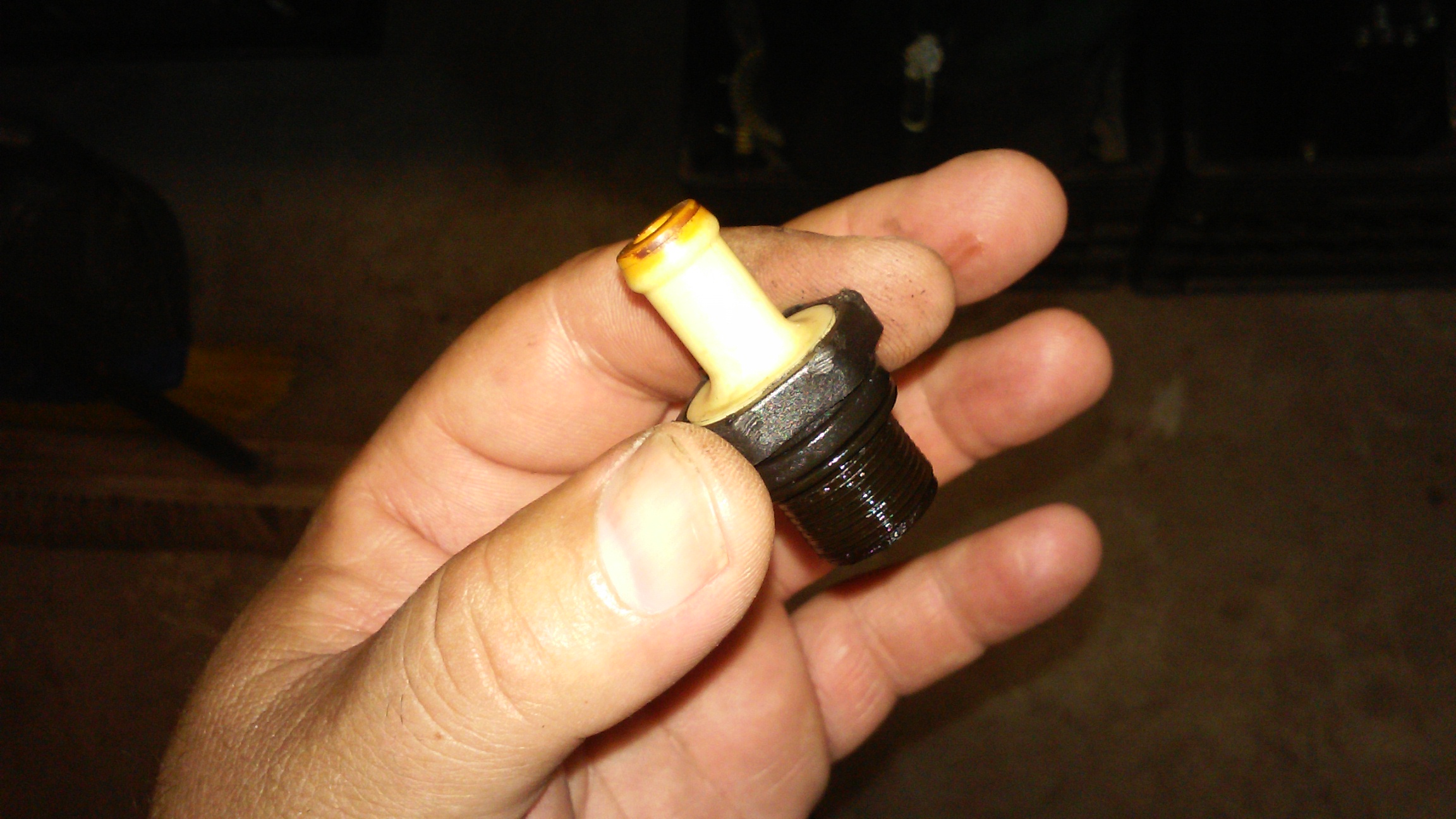

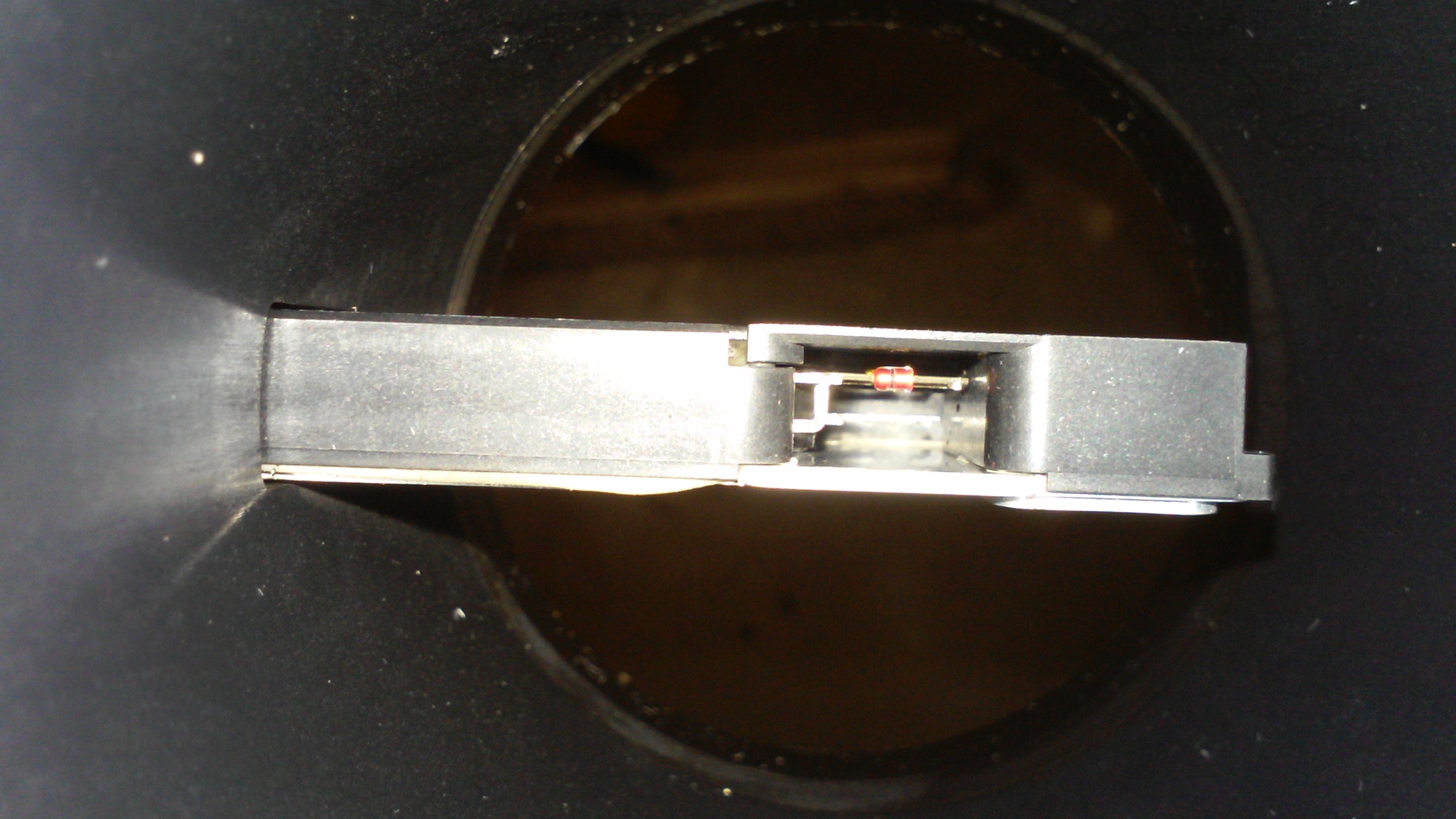

Cleaned and inspected the MAF, it was relatively clean to begin with. No obvious defects noted, reinstalled. Cleaned, inspected and functionally checked the PCV valve, no defects noted. No reason to replace it, reinstalled. During the MAF work I noticed the air intake filter was extremely dirty, replaced it. Now I will monitor, hopefully the problem will be fixed. I will post with an update in the near future.
